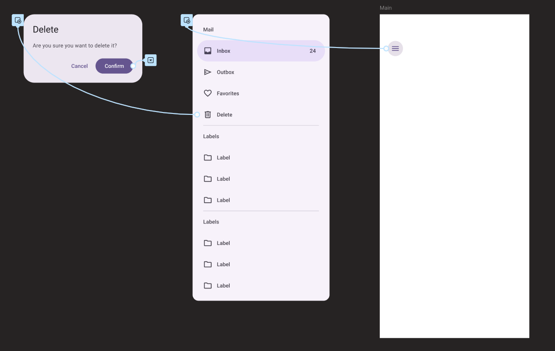

How to close the previous overlay?
Hi folks.
Imagine there’s a Navigation drawer which opens in an overlay.
Now you pick an item from the menu and it opens a dialog - obviously in another overlay.
Now, how to close the previous overlay?
This is my sandbox:
Figma – 16 Nov 24
A few screenshots:
Here is a screencast, showing that the underlying overlay with Navigation drawer doesn’t get closed.

Change Close overlay on Confirm button to Navigate to Main frame

Oh my goodness! 🙂
Thank you, @Nellya!
