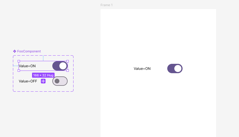

Answering to myself.
I managed to do this via Variables.
  • make both variant switching prop and the checkbox switcher prop of the bool type
  • create a so called “LocalVariable” of the type bool too
  • connect the instance variant prop and checkbox switcher prop to the created local variable
Details are in this video that I recorded today:
