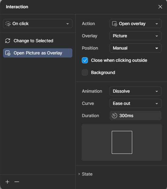

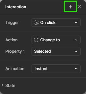

Hi,
in Figma you can assign multiple actions to one trigger. For example, change the component state to "selected" first and then open the overlay. The attached screenshots show how you can configure this.
Add action
Configuration
Hope it helps!

Thanks so much! I swear I have tried adding the interactions before and it didnt work but it works now!
