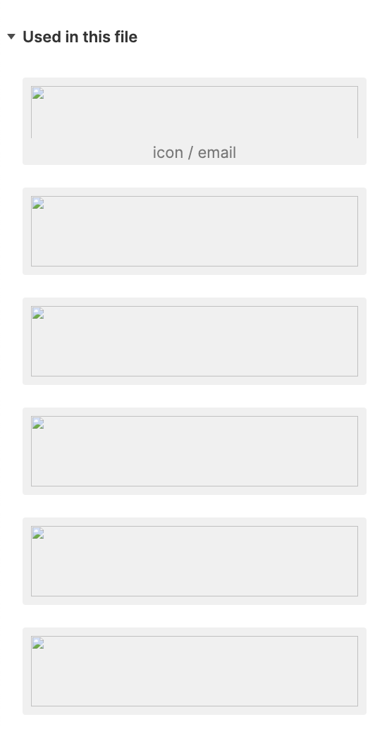

I deleted the original of a component but a reference to it remains in the Assets panel under “Used in this file”.
  • Dev Tools reports it as 404.
  • Trying to place it in a page results in the error message “You can’t add an instance of a shared component into the document from which the shared component was published if the original component was deleted.”
    Wondering if anyone’s encountered this and if so, what steps can be taken to remove them from the Assets panel

When you delete a component, it doesn’t detach its instances. So if you still have an instance of that component in the file, it will be shown in the “used in this file” section. You can find instances in the file using plugins like Instance Finder (however I’m not sure if it works when you can’t find one of the instances yourself).

Thanks again! Unfortunately none of those plugins were able to narrow down the instance. Through trial and error (deleting various components in which the ghost-components were likely to have been nested) I was able to narrow down the instance that was causing the problems. By deleting that master component, I can see that the broken links are deleted along with it. So I’ll simply rebuild that component, relink all references to the new one, and delete the problematic one. Thanks for your help, Gleb.

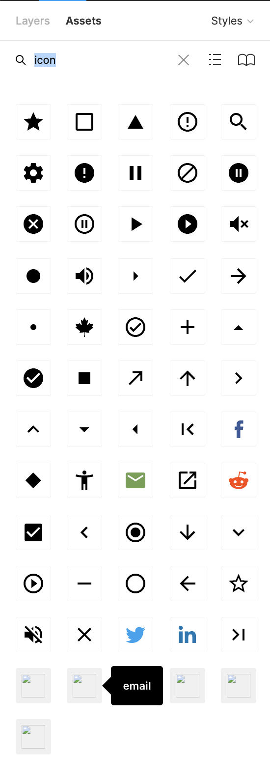

I had the same problem
I used “Figma Finder” plugin
Searched the name, the plugin will return a list of components and instances containing that phrase.
The component will be located on the file by clicking on each item of the list. Then you can either delete it or choose to detach the instance.
