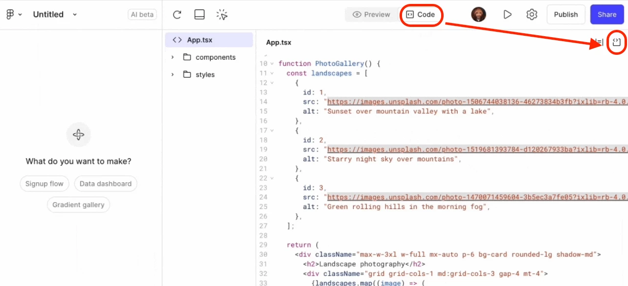

Now for Figma Make: Just open the Code interface and look for the "Download code" button in the upper right.
Hope this helps clarify things.
