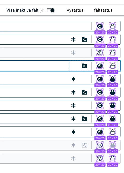

Hi,
Can I create multiple auto layouts at the same time?
I want to put icons next to each other in horizontal auto layouts without having to dig my way through 150 rows manually. Any help would be greatly appreciated :)

This is a job for components. Ideally, all of those rows should be instances of one component. You win by only having to design one element and it’ll update all rows. The component can have properties for selecting the different icon variants. Check this guide out.
If you just want to tidy up what you have, you could try your luck by selecting all rows, right click and then More layout options > Suggest auto layout.
