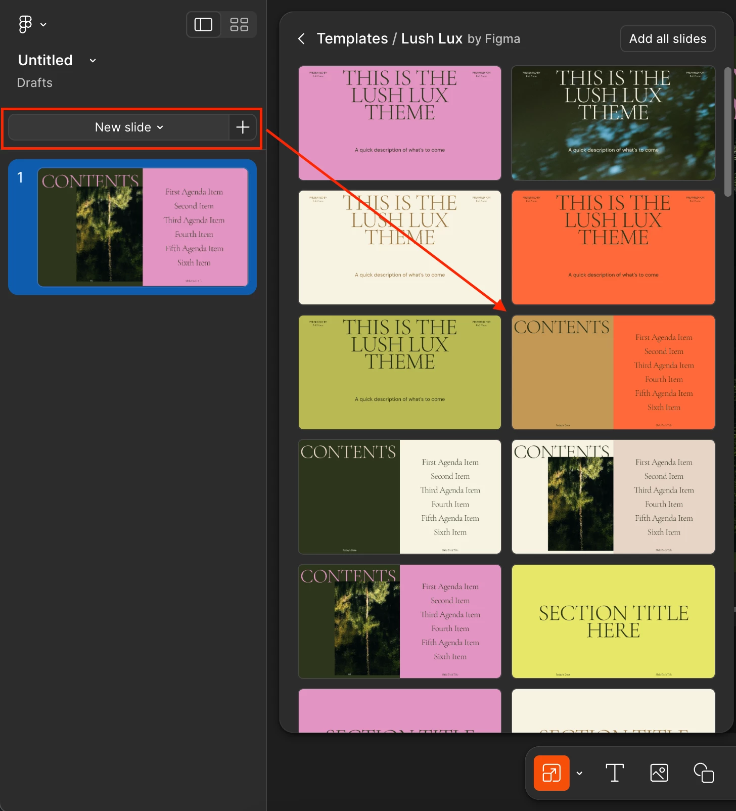

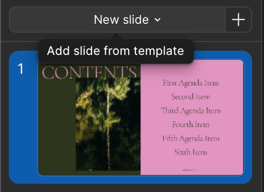

Hey ​@Shelene_Lee1, thanks for reaching out!
It is not possible to change a Slide’s layout after it’s been created, but you can add a new slide template from your chosen Template by adding a New slide from template. You’ll see a tooltip appear when hovering over New slide. Then, you can select a different Slide layout from that template.
I’ve updated this topic into a feature request and passed along this feedback to the Slides team for future consideration to make this process more frictionless. But in the meantime, I hope this temporary solution helps!
