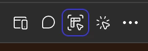

How can I get a prototype I made in Figma Make out so that I can edit it?
I wasn’t sure how to make some interactions, so I ended up prompting Figma Make to make them happen, but now I can’t get everything out to edit. Do you know how I can do this without paying for a code converter to convert the code back into a Figma deisgn?

Hi, ​@IAmAStudent - thanks for your post and great question!
Have you tried copying the design in Figma Make? When you are viewing the preview in Make, to the top right are five different icons directly under the Share button. You want to use the highlighted one:
A screenshot showing the Copy Design button.
That will copy the design so you can open a Figma Design file and paste it in. Note that this won’t include interactions, so you’ll need to set those up yourself. Depending on the interaction, you can use the Add interactions option in the Actions menu to automate creating some of them.
