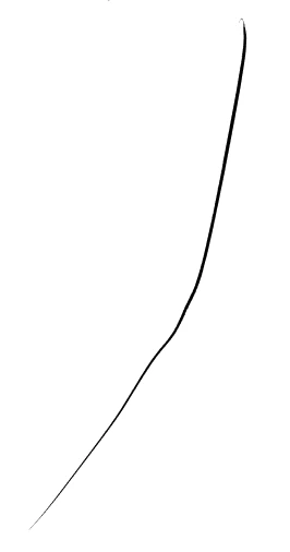

I want to use a pen tablet in Figma Design.
It basically works out of the box.

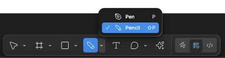

The `Pencil` tool supports pen pressure, but how can I disable this?
I want always to draw with a fixed width (like when I use a mouse).

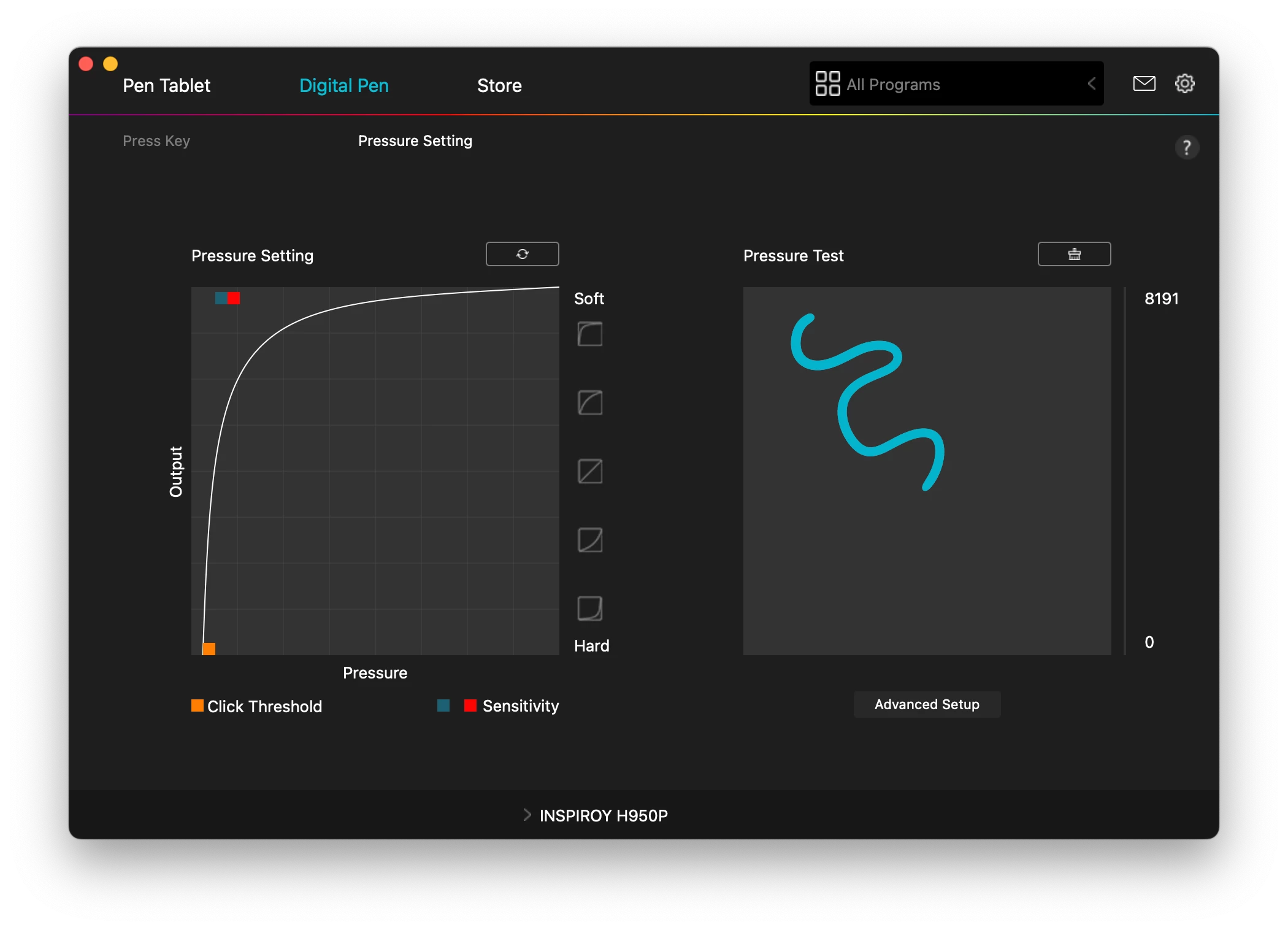

Yeah, some months ago it was working with a fixed width, but now it has this strage default pressure. For the moment what I do is setting the pressure to extra soft in the digital tablet software that I use, so it helps a little with the pointy ends on Figma.

For posterity, we added a quick action a few months ago to turn off pressure sensitivity!
  • “Enable stroke pressure”
