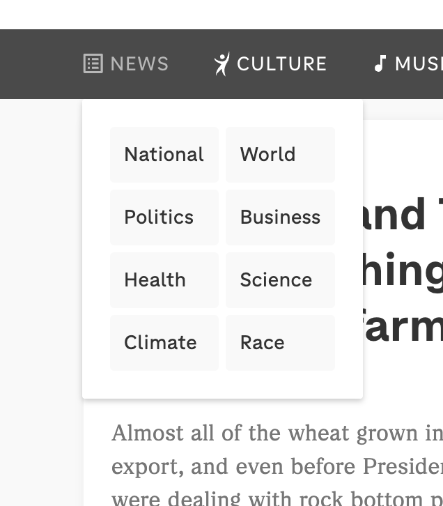

Has antone figured out how to create an overly in Figma Sites Yet?
What I want to do is this- a dropdown menu off a main navigation on a website. In figma OG this would be pretty simple, but FigmaSites doesn’t seem to support it. Am I missing something?

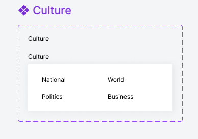

Haven’t test the hover behavior. But here’s the on click behavior
Demo:
https://file-patch-92076901.figma.site (Will delete it soon)

​@Jonathan-Liausvia this works. But the only way to close the window for me is to keep the frame size around Culture text bounding box and have the rest of the component out of the frame. Make sure it’s not clipped to content, otherwise the drop down menu will not show. The interaction I’ve selected to go back is a click interaction. Hope it makes sense!
