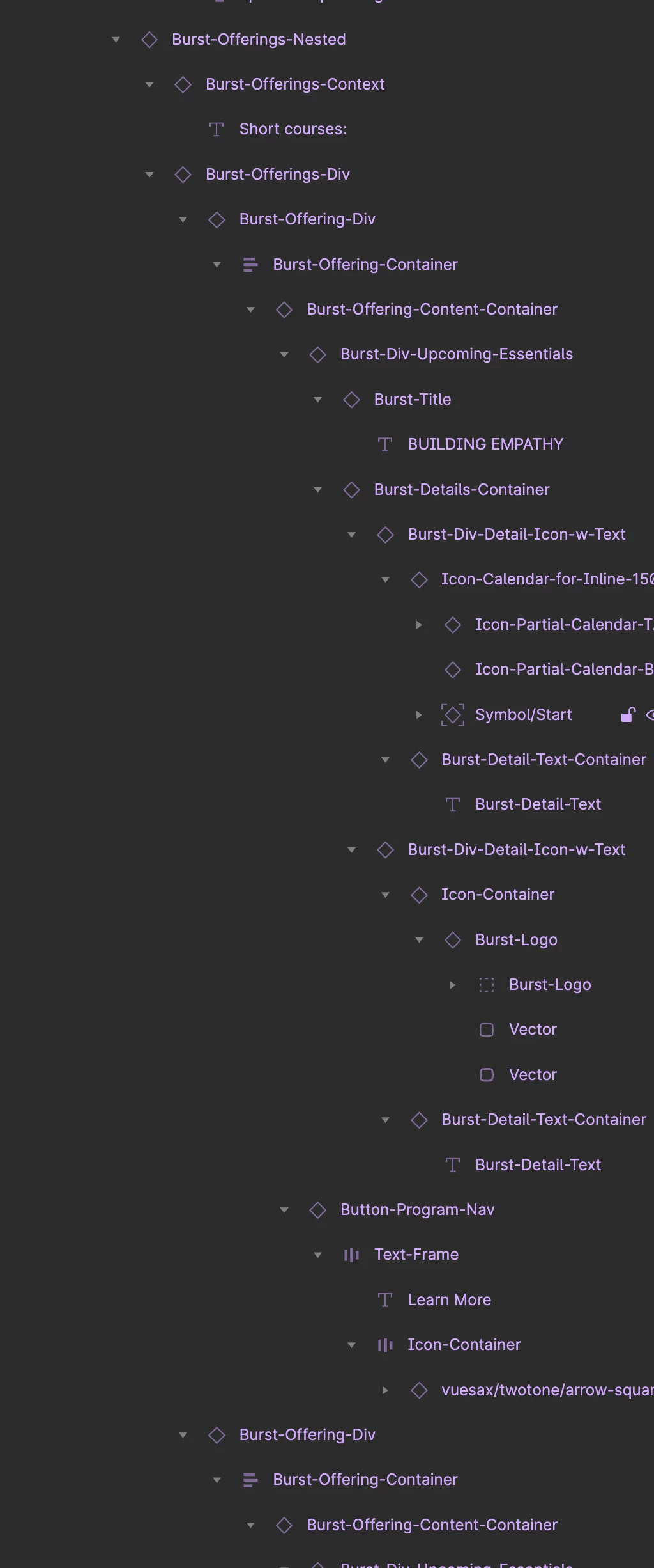

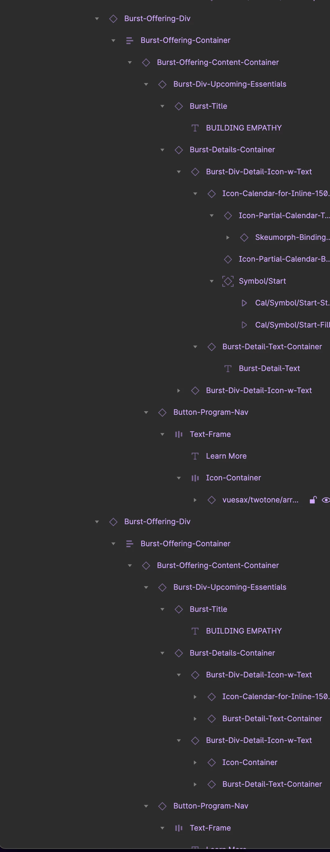

  1. Once you make something a Component, the little purple component Icon takes over and you no longer know if it is an Autolayout, a Frame, or a Group. Not a problem at first, but if you are REALLY committed to components you will nest components inside components inside components inside components. You will have one component made of 50 other components.
But then your design isn’t behaving the way you want, you have to go into every thing that could be causing some glitch. It’s usually some Fill vs Hug vs Fixed fiasco with Autolayout. Though more and more I’m running into Frames and Groups (and Groups inside Frames) that are automatically set to Left and Top constraints, and need to be set to Scale and Scale.
But, because the little purple diamond of death is just a purple diamond, you have to click through every one to see which Frame or Autolayout setting in which nested component is the obstacle to responsive layouts. Then when you find it, for Frames and Groups you cannot change its Constraints from where you are, you must go to the SOURCE component (usually in the design system file).
Now wait just a minute, yes you think you found the problem. But, it’s a nested component!!! So then you must go to the source of that. And that YES it’s in your Design System, but it’s on another page. It’s on your Containers and Wrappers Page. So then you go back to the Design you are working on (but actually you might not even remember where that was, or if you are ADHD like me you totally forgot what you were trying to do in the first place.
Okay so your back to your design. And it turns out that IT DIDN’T FIX THE PROBLEM. You go back to your Containers and Wrappers, nope that’s fine. Oh wait, it’s the ICON. Yes it’s the ICON! The Icon is a Group (but you don’t know it is because of the purple diamond and it is not on Scale Scale, it is on Bottom Right. WHO DID THAT! (Hint, it was me. Two weeks ago.).

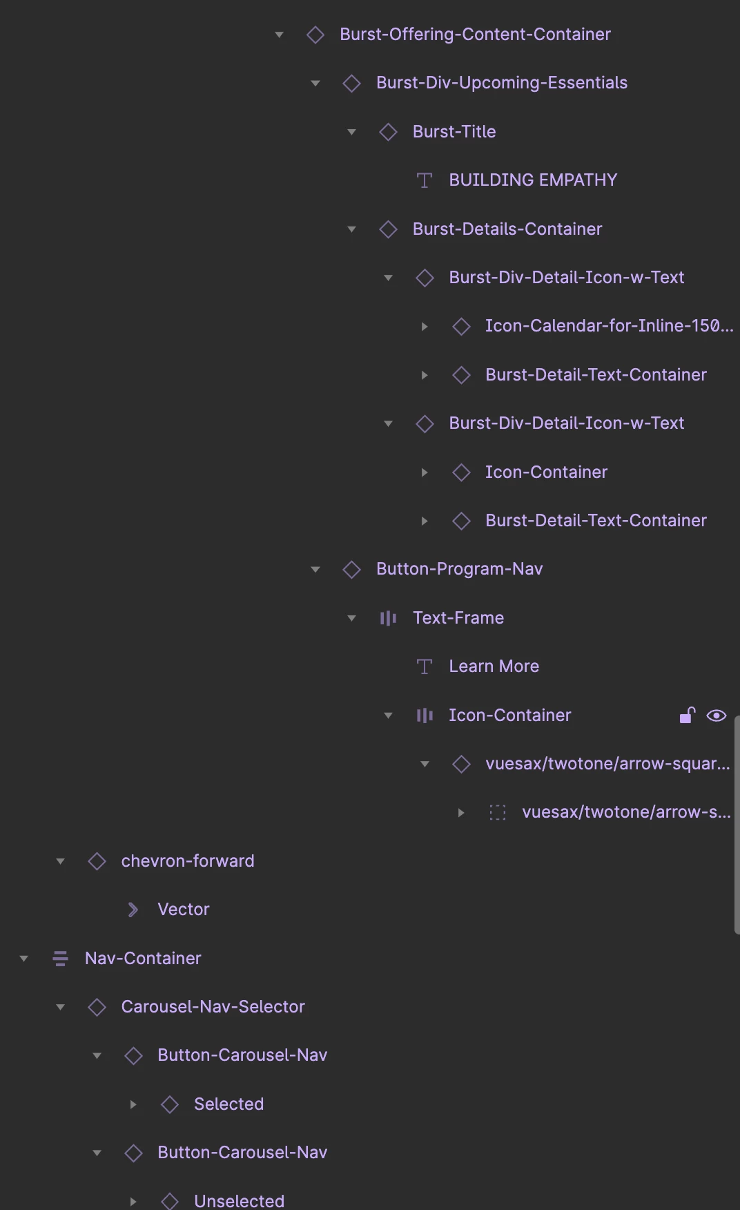

@ksn So for this one, I have one quick fix a few gigantic things that may never happen:
  1. The purple diamond is cool, but your little autlayout, frame, and group Icons should be in it somehow. I should just be able to look through the left hand navigation to see that, not follow the neverending “Go to main component” “Go to main component” scavanger hunt.
  2. (harder) make it so that you can change the Constraints of the child instance object (an instance of another component) within a parent Component.
  3. (harder) make it so that you can change the constraints the entire stack of NESTED objects from the parent layer. You can change it for multiple objects that are peers by selecting them all. But you can’t in one fell swoop set the constraints of everything to Scale Scale (which is a super frequent bug, I’m trying to scale up a component.)
  4. (probably really hard) Every component anywhere gets two locations for the “main component” – the source of truth. One is wherever we put it in our design files. The other is in a completely opinionated Component Library that Figma creates for every File and every Team. The entire point is to have them in Alphabetical order, (maybe you could sort them by other conditions) but that way when you are in Nested Component Hell, you don’t end up jumping across files and pages and sections. They’re all there in one place. So if you have to traverse 10 different components to find the source they are all there. Maybe it’s just a pop out of the asset library on the left column that allows you to edit components without the jumping.
  5. (probably really hard) You have a “Debug” interface, similar to IDEs. If I’m in a component that have a bunch of layers of nested components, and it’s not behaving how it should, I can press “debug” and it will have some fancy column or row of all components in the component tree, and all of their properties are there in one view you can scroll up and down or left to right.

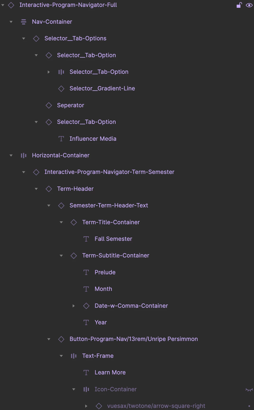

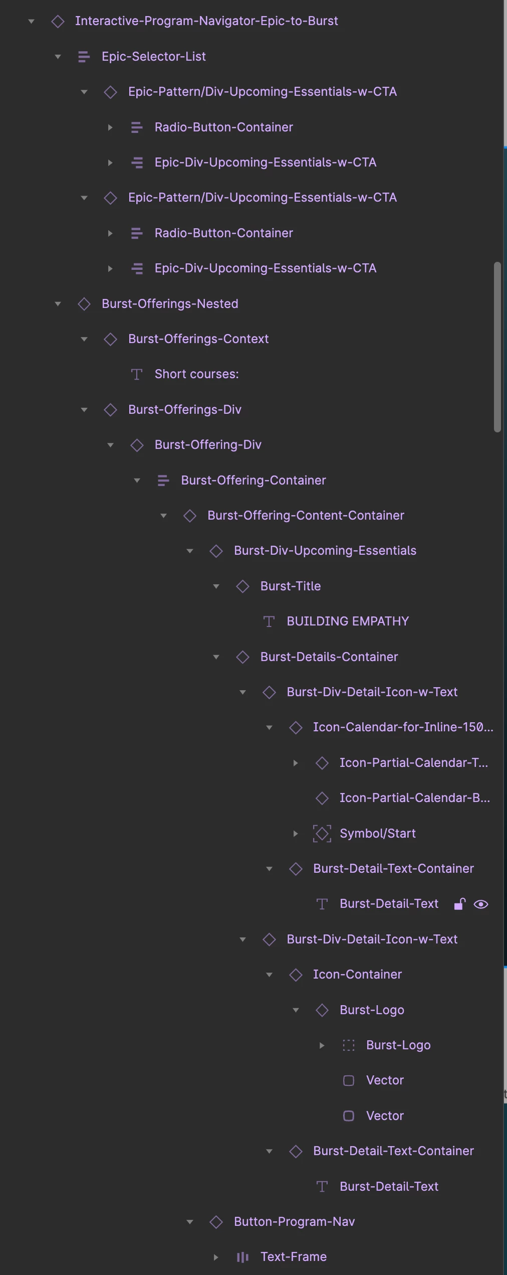

@ksn here is the file and component tree for the component above:

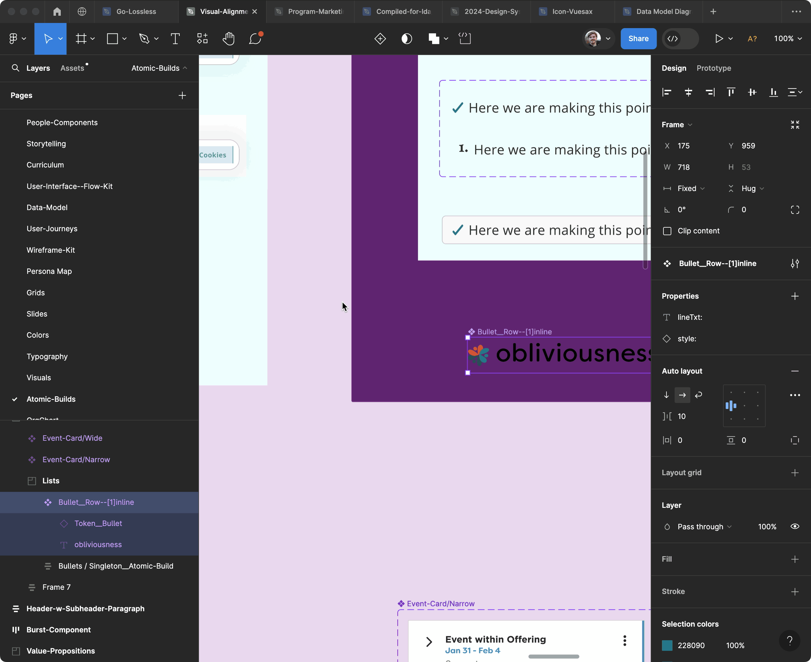

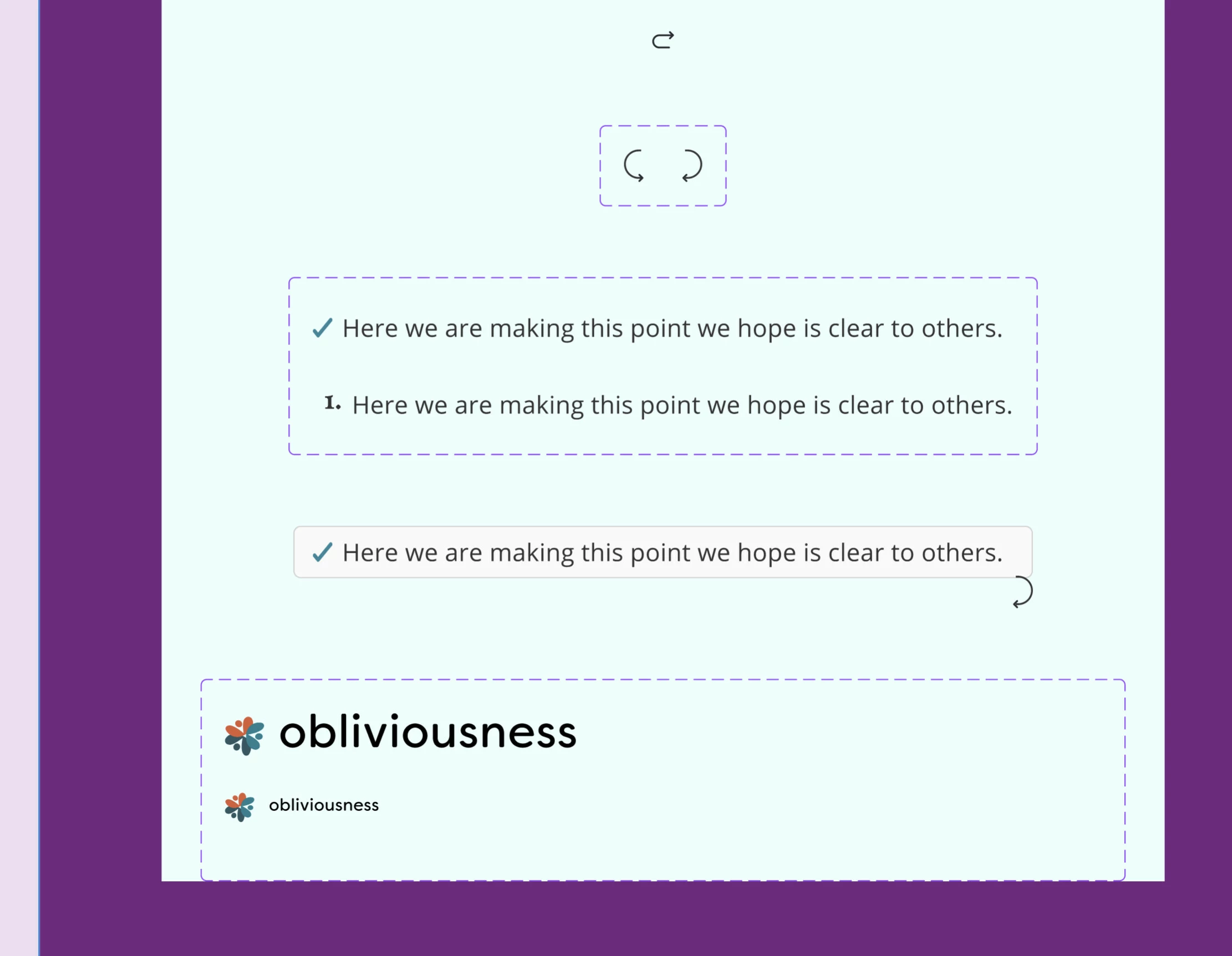

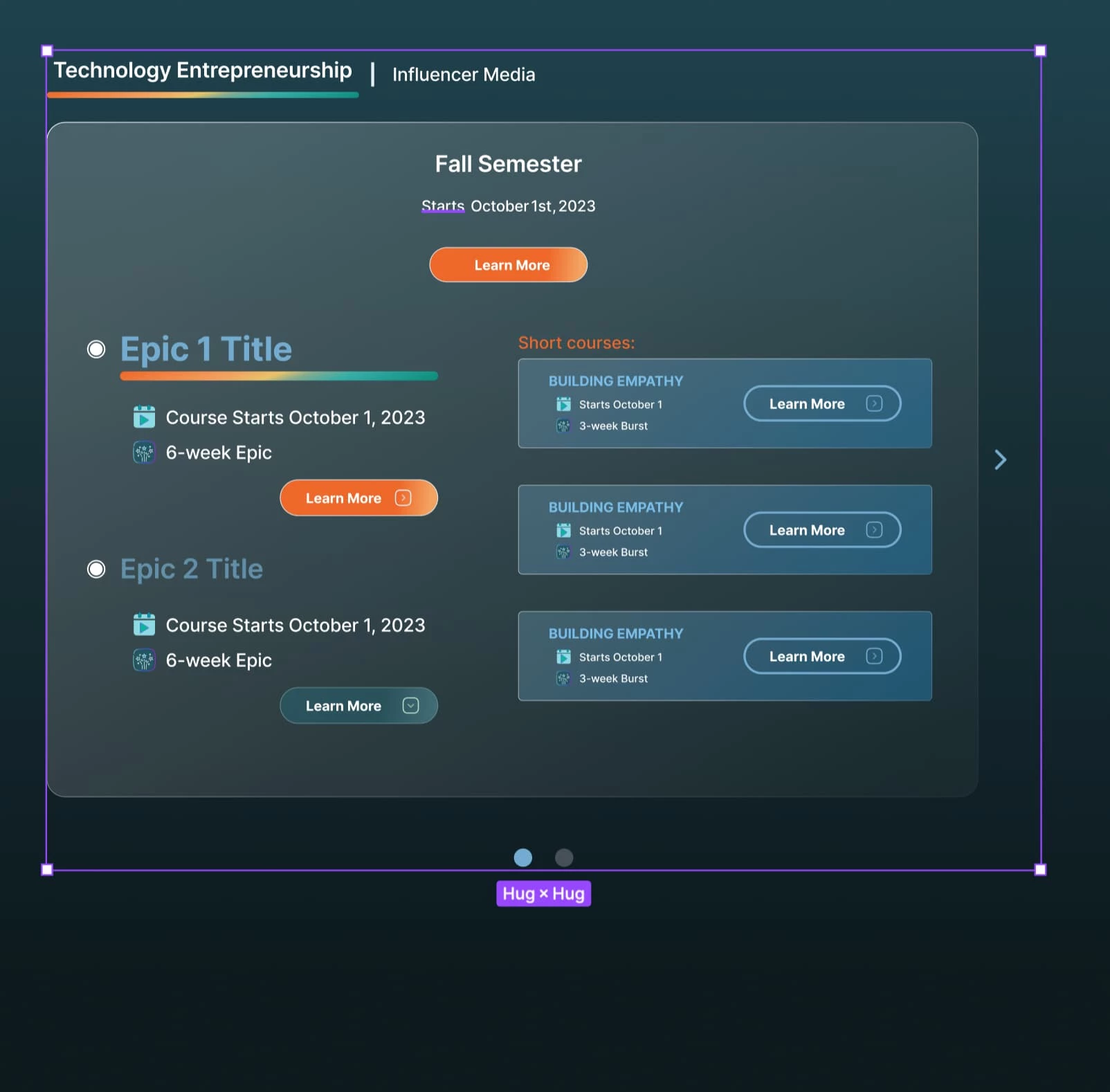

@Pavel_Kiselev and @ksn , Here watch me be totally unable to debug one simple component: I want to adjust the size of the bullet icon in a bullet point. I want to make it 24x24 instead of 32x32.
Notice how I don’t have access to the width and height fields.
I mean, I can go create a variant, but then I have to manage that. Usually, I can scale a component object if it is set to scale scale in the main component, and this is.
I would like to get a response on this particular case. However, it’s representative of how I find myself increasingly spending my time. To the point where I feel like I’m not doing the work I’m supposed to be doing.

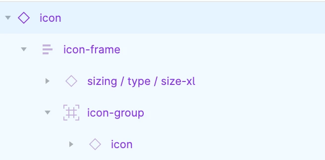

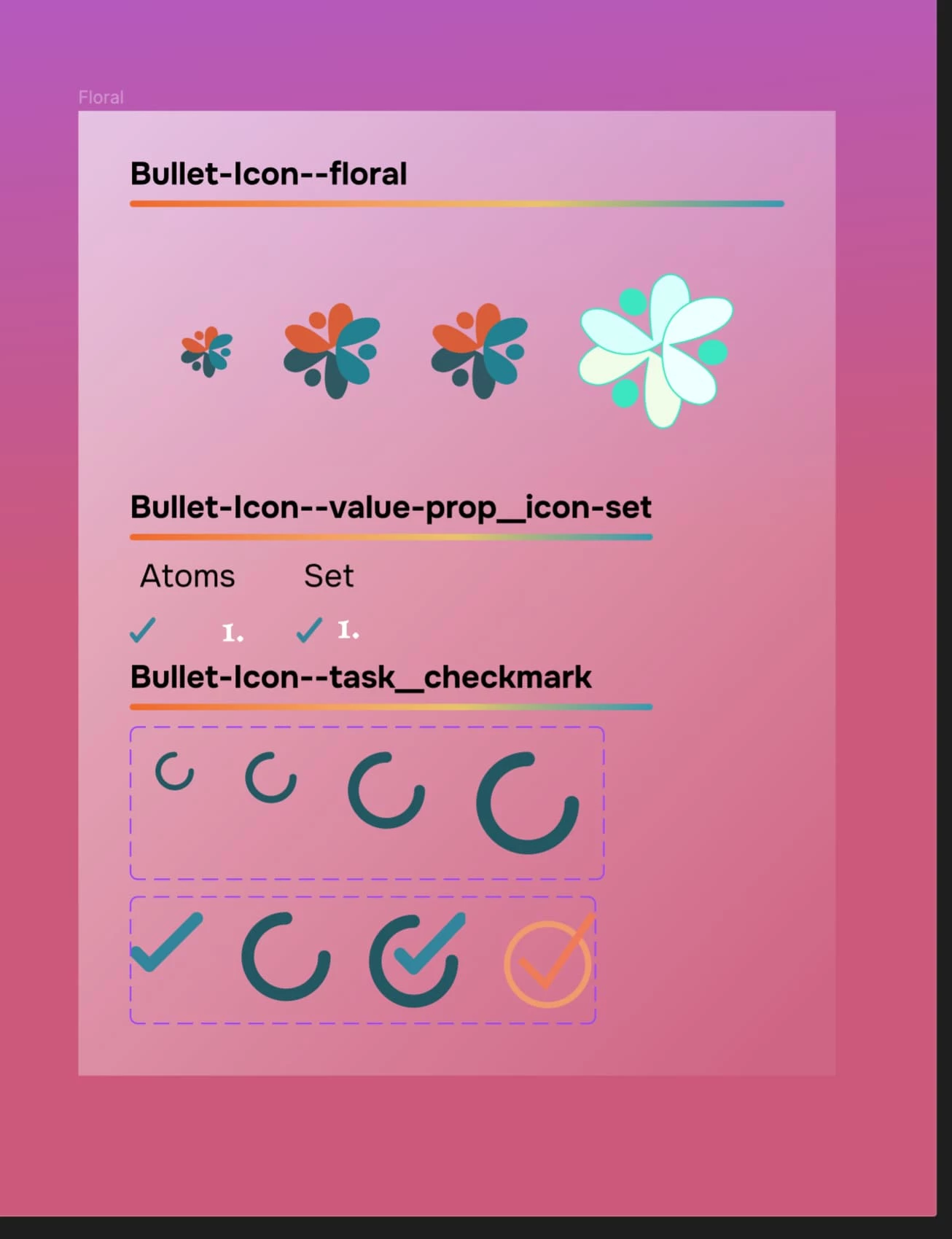

Seems like a learning curve issue to me mate. I’d do it a bit differently for your specific example with the “Bullet_Row” thing. For me, it seems like a very common UI pattern. It’s a text label accompanied by either leading or/and trailing icons. And you want to be able to resize icons with little to no effort. I would use a few key ingredients here.
  1. Icon image component, you can use whatever imagery you have, just make sure it does scale properly when you resize it.

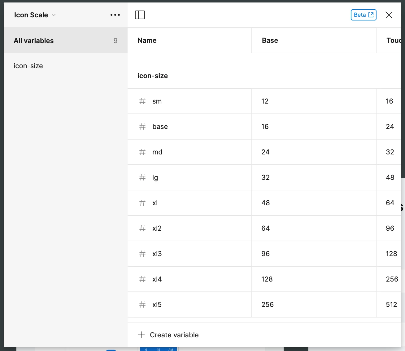

  2. Size token component that sets a scale ramp for your icons, bullets whatever.
Size token is a key here.

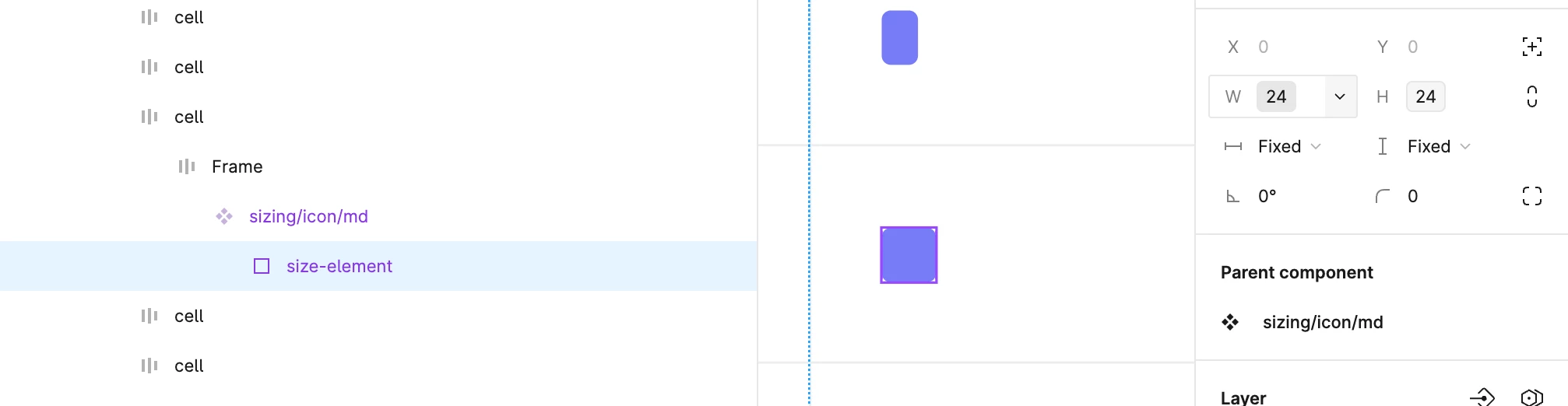

I made a simple rect and set its size with a variable, you can “hardcode” it though. Then I wrap it with Auto Layout frame that hugs the sizing element. This is important because only auto-sized elements will be able to change their size when you swap instances. Repeat multiple times for multiple sizes you want to support.
Here is what I got for my needs

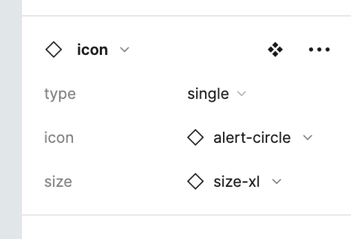

Then I combine an icon with the size token into a generic icon component with two properties.
As you can see the size of the component is set with size token. The image is sitting in absolute positioned frame that grows/shrinks with the main component.
I use the icon property to swap the image and the size property to swap the size token.

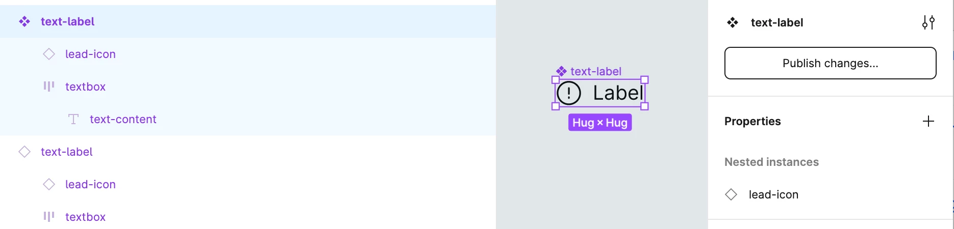

Finally, I combined the generic icon component with a text layer to make a text label component
Here is how it works

@Pavel_Kiselev first, thanks so much for being thorough in your response. I don’t generally have good luck with forums, it’s very rare that someone actually tries to help and can (outside of Stack Overflow). So, really, thanks. Also, your community “playground” file has some interesting components. So, I shall be stealing some. And, I like the way you do sizing. I tool your advice:
BUT… lol
I know it’s easy to make a variant set at various rem, em break points. That’s super necessary in some situations. I have these below.
However, in quite a few situations that I run into every day, I just need to adjust the size of something and I can’t. And, the nested properties stack is painful to debug. So, I’m not arguing with you as much as saying: I can agree that variant sets with sizing are a best practice and I should stop praying for features.

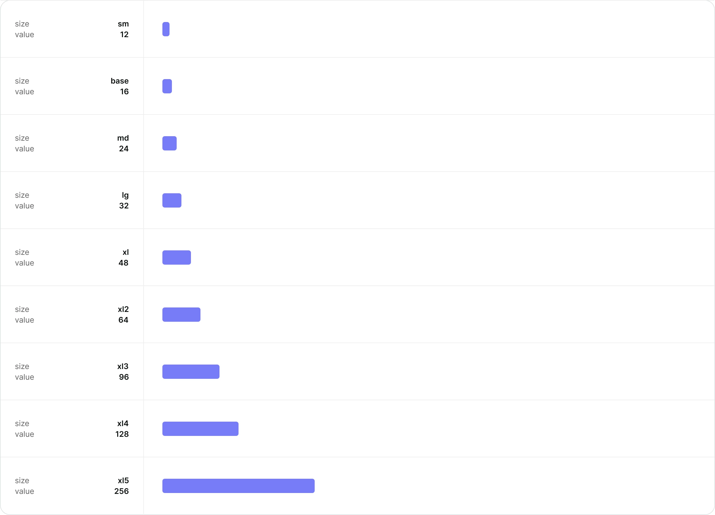

Well, for me this is the whole point of the standardized image component and the size token underneath. This way you define images that are predefined to have certain sizes, on a scale you wouldn’t want everything to be any size as you try to fit everything into a system.
IMO my technique makes memory efficient components that are easier to maintain as I don’t have to repeat myself repeatedly to support sizes on various images here and there. I’d prefer not to do this →
I can see at least 3 component sets with 4 image sizes which are the same. I am too lazy to maintain it )
