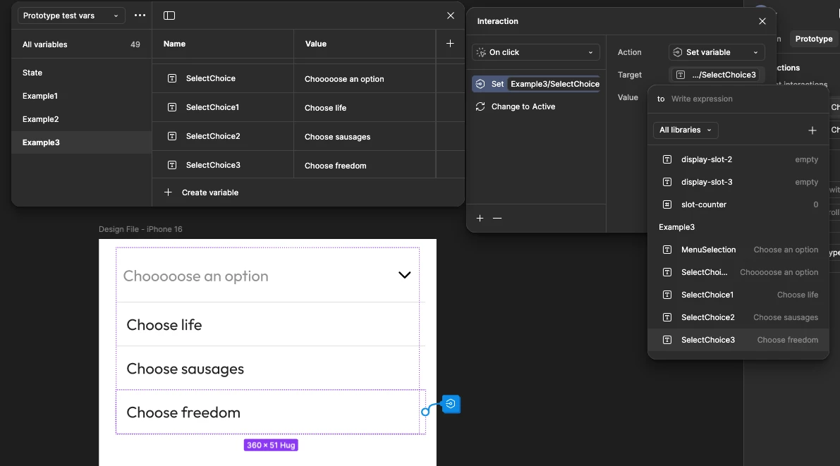

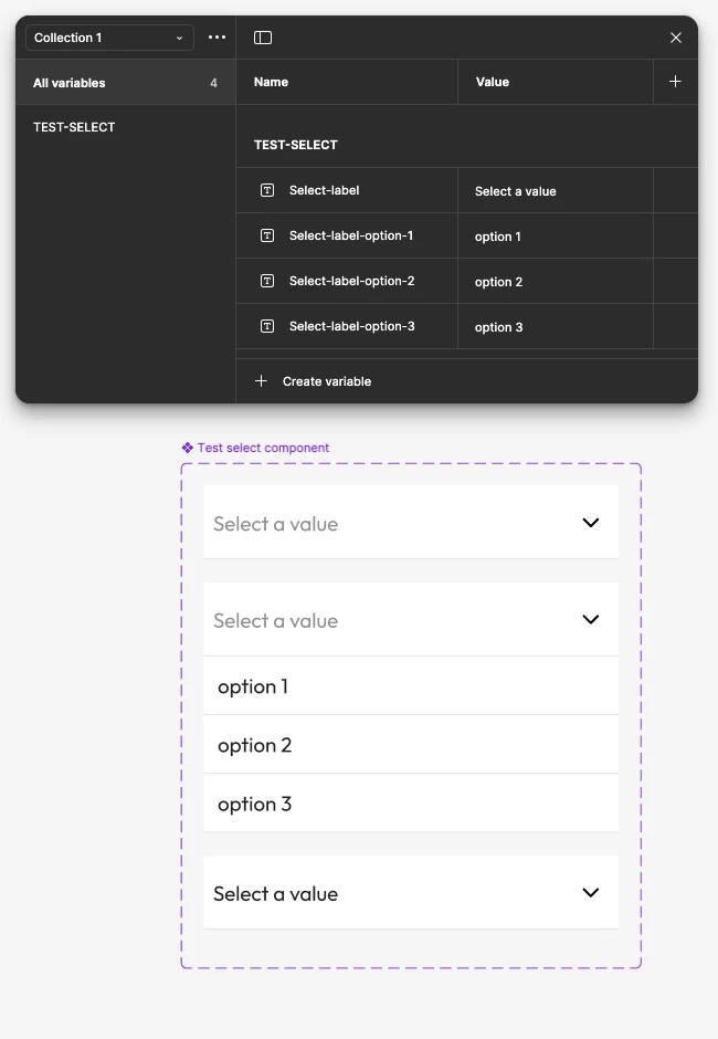

Hi ​@Rizwan ,
Essentially, for each option in your select dropdown, you need to make sure the prototype click action is updating the new variable you have created locally, and that the select label is also referencing the new local var, so that is is displaying the right option on click.
In the images below, you can see the master component is using local vars (TEST-SELECT/Select-label, etc).
When I want to use this component in a different file, I have to make sure that the new file has the same variables (can be called something different) and that the prototype click actions are updated to use the new vars. In my design file where I want to use the component, I have created a new set of vars (EXAMPLE3/SelectChoice, etc). For the label, and each option, I also needed to update the variables they use to the new design file vars.
If you do not update the vars used on the click actions to use your new options in the design file, the component will pull in the options set in the master component files variables, which I believe is what you are seeing. What you see on the label is not what is being pulled into the var on click.
Hope that helps.
