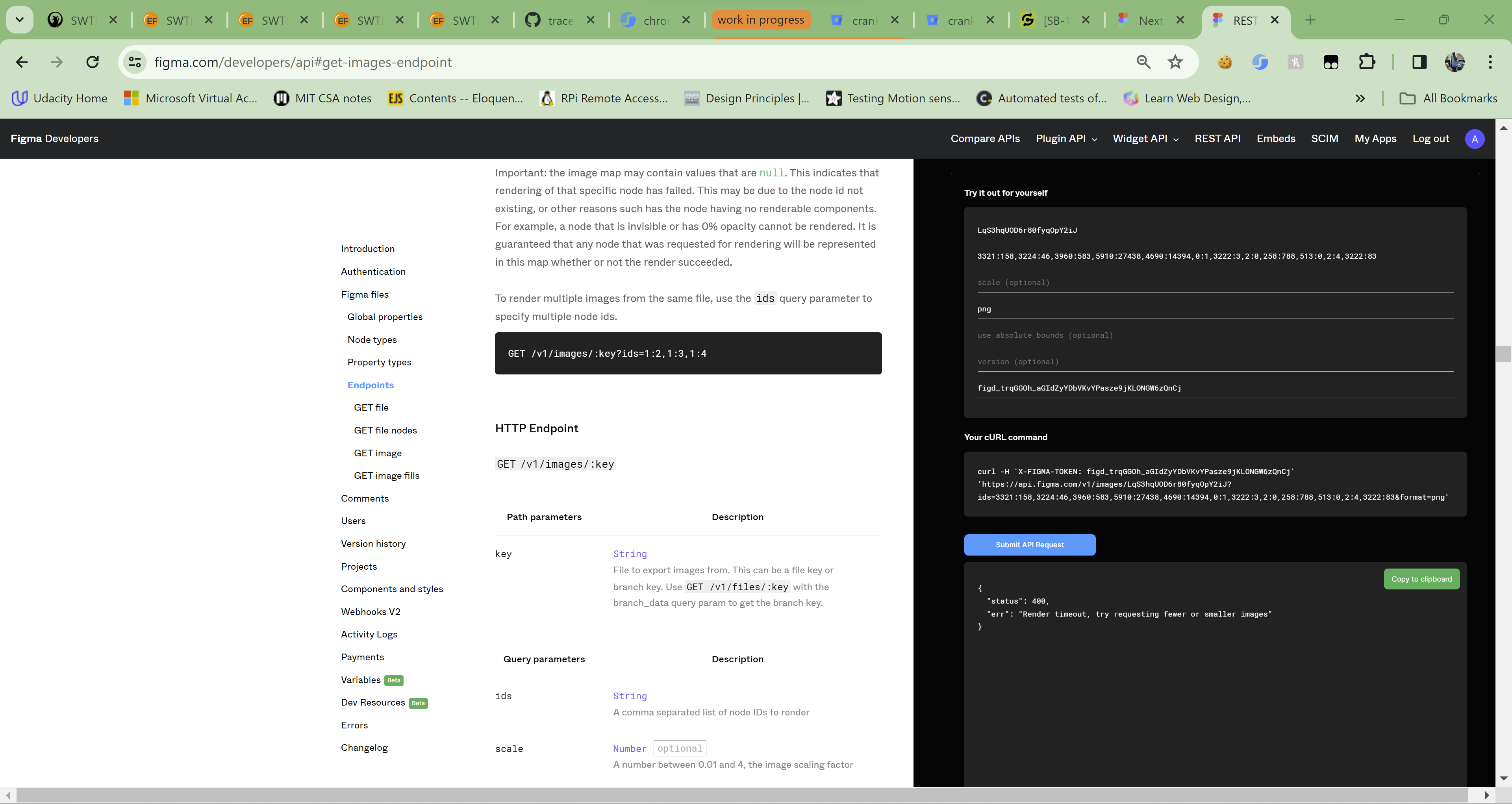

After performing the Figma GET request that fails,https://api.figma.com/v1/images/<figma link id>?ids=3321:158,3224:46,3960:583,5910:27438,4690:14394,0:1,3222:3,2:0,258:788,513:0,2:4,3222:83&format=png in the Figma provided portal here, https://www.figma.com/developers/api#get-images-endpoint , we get a timeout error
{ "status": 400, "err": "Render timeout, try requesting fewer or smaller images" }
The documentation(https://www.figma.com/developers/api#get-images-endpoint) does not say anything about the maximum image size. Does anyone know what the maximum image size for GET Image request?
