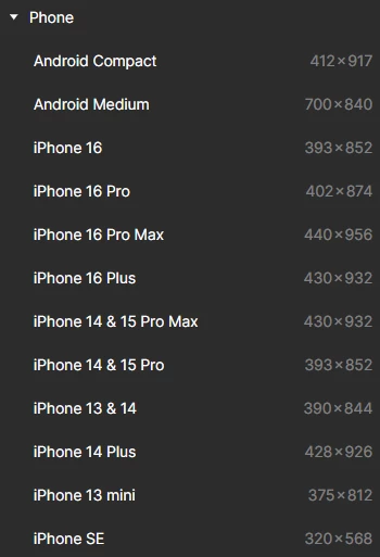

Hello. How do I find frame to use? I want to use the frame of a cell phone. I am building an app.
Avokadomos
Figma Ambassador
Figma Ambassador
Jan 26, 2025 2:19 AM UTC
When you select the frame tool, you can choose from a range of standard sizes:

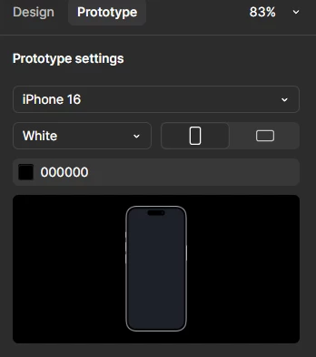

Also, when you open the prototype tab, you can choose what size your presentation will be, and get a device frame in presentation mode.
