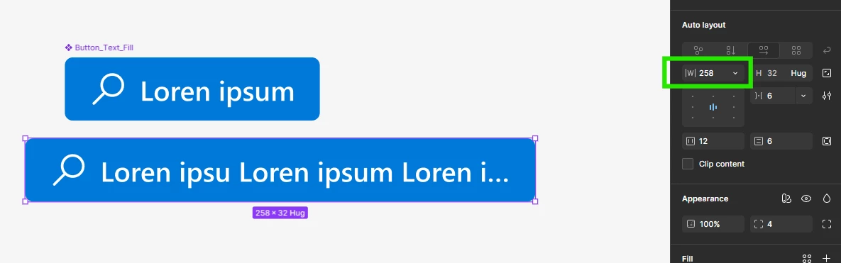

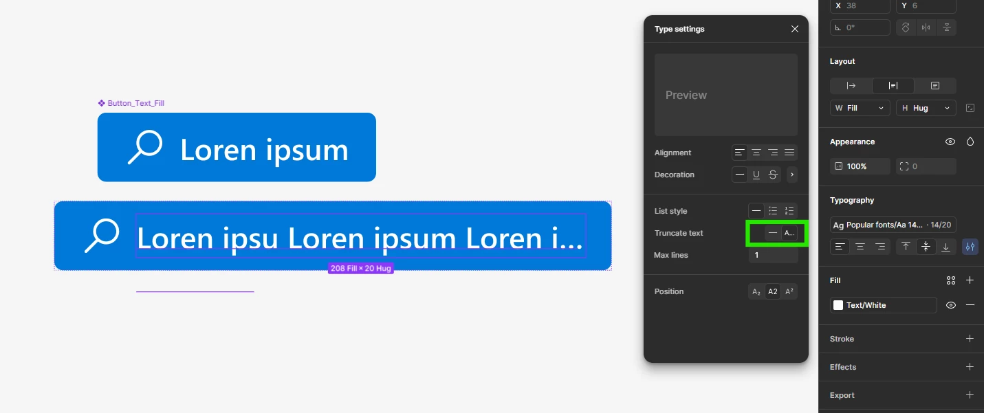

Generally, I stick to setting the main button frame to Hug contents, while the text layer inside is set to Fill container with Truncate text enabled (in Type settings).

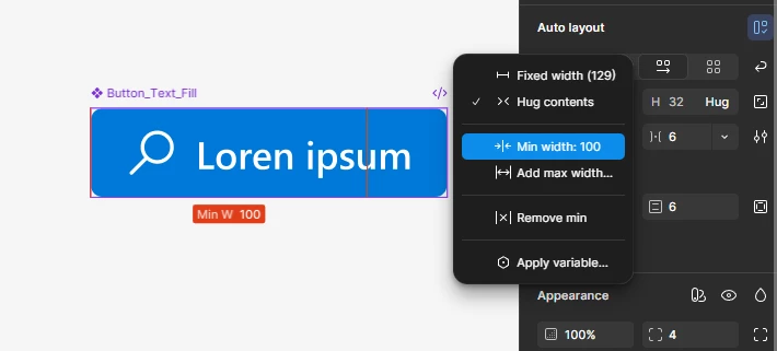

(Note: Setting a Min width on the button isn't strictly necessary, I just find it handy sometimes so the button doesn't get too small when the text is short).
With this setup, as soon as you manually resize the width of a button instance, the button's Hug automatically switches to a Fixed width.
And because the text inside is already set to Fill and Truncate, it works nicely and truncates the text with an ellipsis right away.
