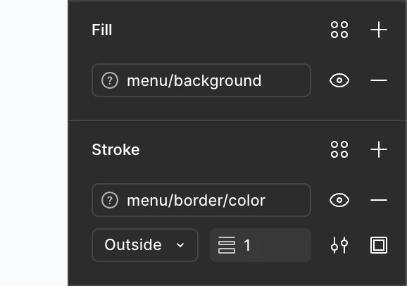

After exporting, many variables or styles in Figma appear as broken (showing a question mark icon).
Although the variables still exist, their values are not correctly resolved.

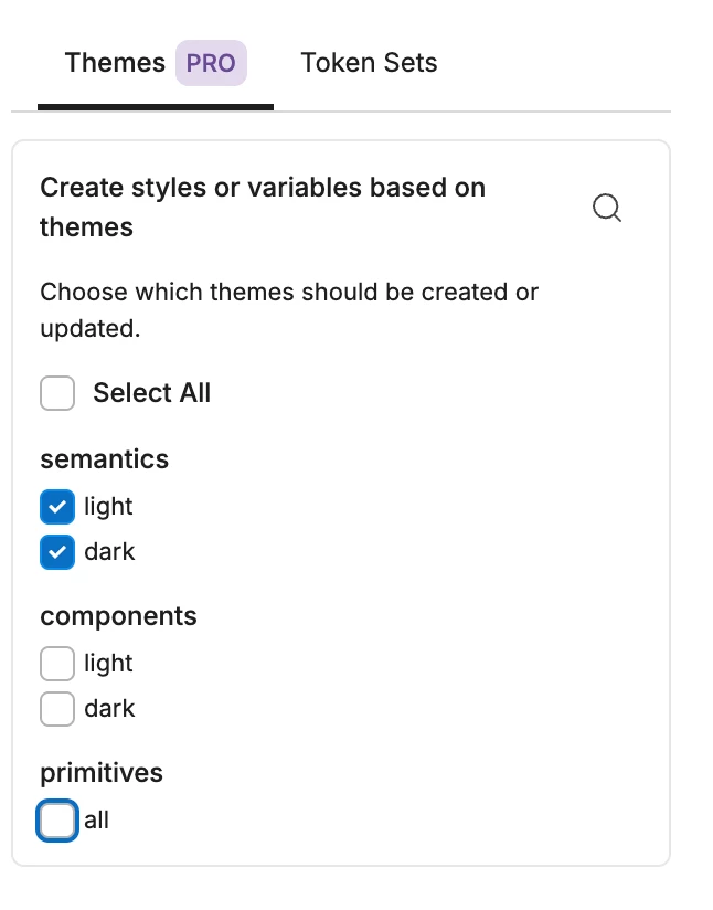

I ran into this issue in a similar workflow and realized (after hours of investigation & testing), that the issue had to do with how I was exporting the tokens from TS to Figma Variables. The way I was able to fix this was by:
  1. Exporting each collection in TS at one time: primitive, semantic, components for us

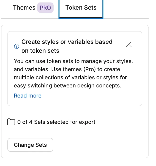

  2. And making sure I was exporting only the themes, not the sets as well (the second tab on the export screen, screenshot attached).
I am still finding the export process to be quite buggy but I was able to rectify this issue this way on my end. I hope you have found a solution by now!
