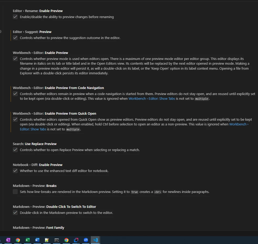

Vivek Gaurav
Jan 28, 2026 9:40 AM UTC
I am using 1.108 version and enabled the preview as well still getting the error
