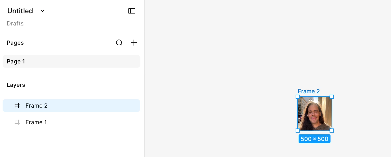

My successful prompt and chat:
use upload_assets to add this jpg to this frame https://www.figma.com/design/ABC/Untitled?node-id=123
The result:​
Let me know how you are trying and what error you get, and we’ll work on it together! — Jaycee
