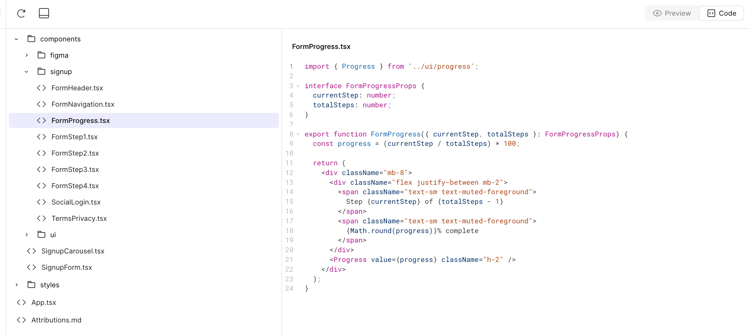

I have a solution to clone the entire project into a new Figma Make file - it’s the history that slows everything down. A colleague has created a guide for - this does work if you follow the instructions exactly. As a note to Figma - an option to clone a file without the conversation history would be very much appreciated.
The guide includes a series of prompts, and some manual copy-pasting, that'll help us migrate existing Make files into a new one while preserving file structure and code. I've tested it 5-6 times and each of those times it was successful!
The guide covers the following:
  • Exporting project file structure
  • Creating clean project blueprints
  • Automated file/folder creation
  • Code transfer process
  • Context briefing for Figma Make
📑 Written guide link: Figma Make Project Migration Guide
