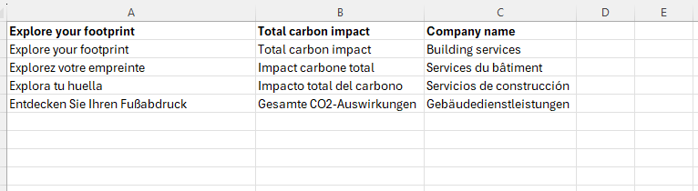

I am trying to create localised assets for my company and using Figma Buzz and the Bulk Create feature.
I paste in the template I am working with into Figma Buzz, upload the xlsx file with the format as attached but when connecting the items and clicking “Create assets” it’s creating the assets but it’s just duplicating them. It’s not replacing the text as per the spreadsheet.
What am I doing wrong? Or is this a bug?

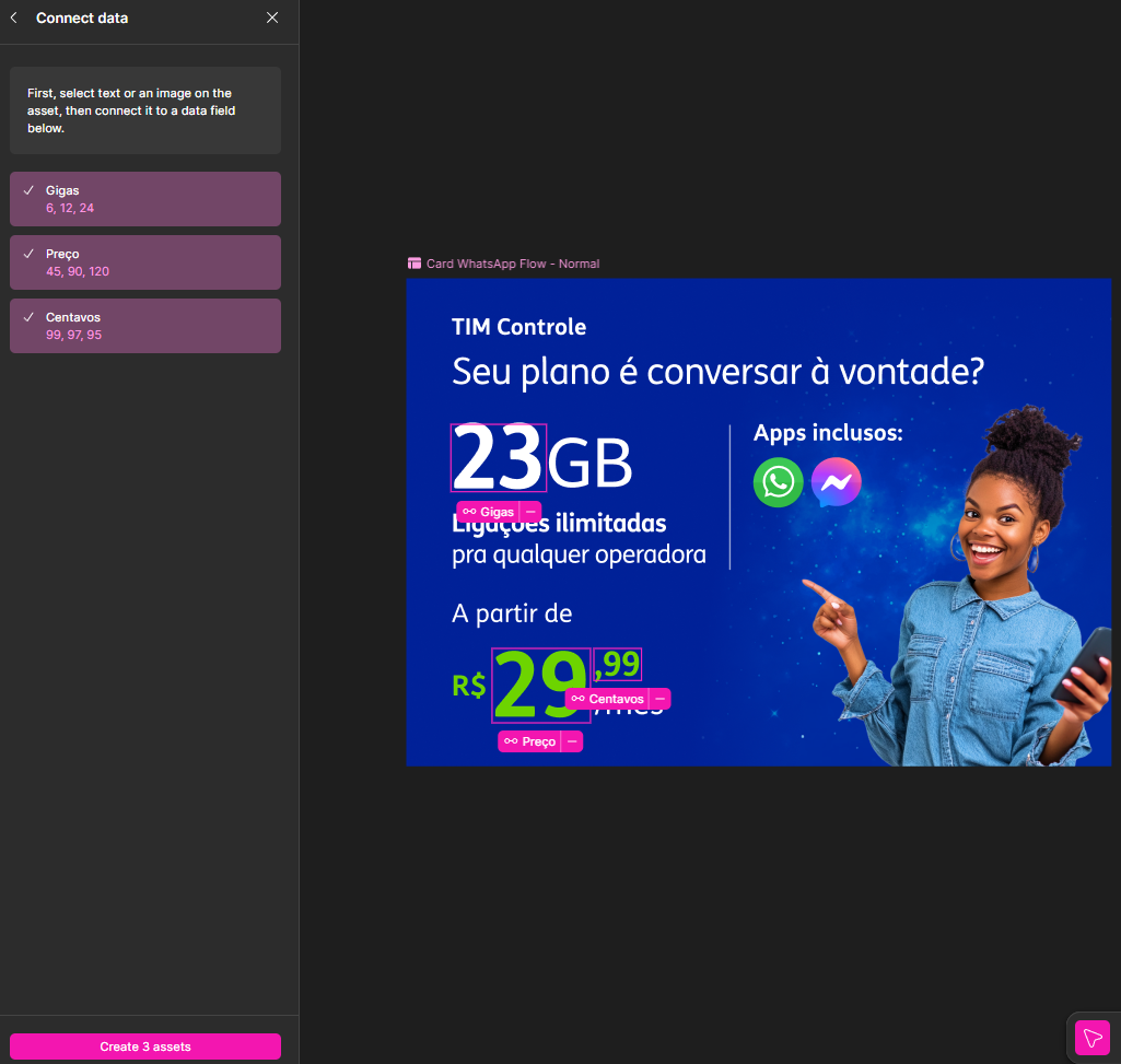

I’m facing the same issue. I’m testing the Bulk feature, but it’s not working. It’s just duplicating the original layout.
That’s what I’m doing:
Uploading this simple sheet:
Mapping:
But when I click to create, this is what happens:
Am I missing something?
I’ve already check for Figma Updates and installed them.
Thanks!
