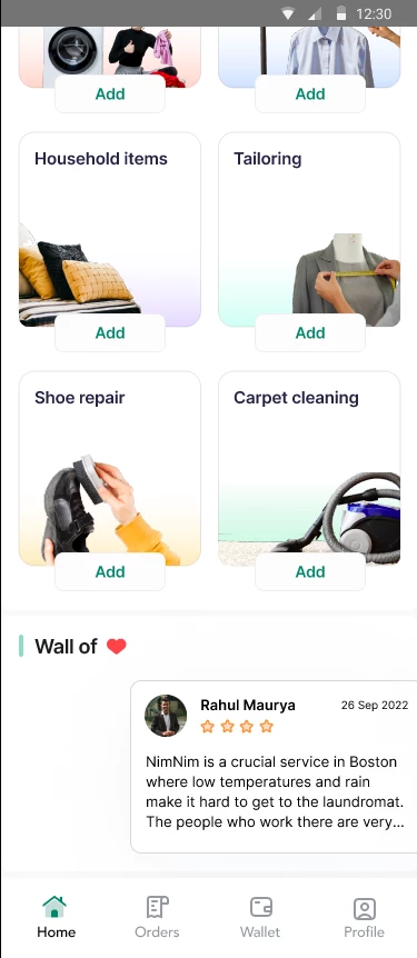

Extra white spacing when scrolling horizontally
I am trying to horizontally scroll two frames inside a parent frame. While the scroll is working fine, there is an issue of extra white space occurring at the start and the end of the scroll.
I am not able to get this issue fixed for some time now and seeking help for the same. Attached are the screenshots of the screen.

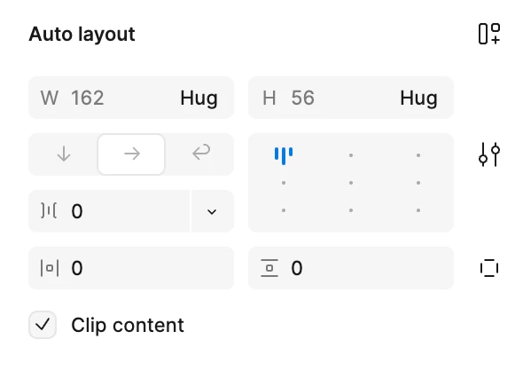

portfelio
Jan 16, 2025 10:28 AM UTC
I’ve been struggling with this issue for many months. The solution is to make sure the items you’re trying to scroll have clip content turned on. This will then get rid of the extra spacing at the start and end of the parent scroll frame.
