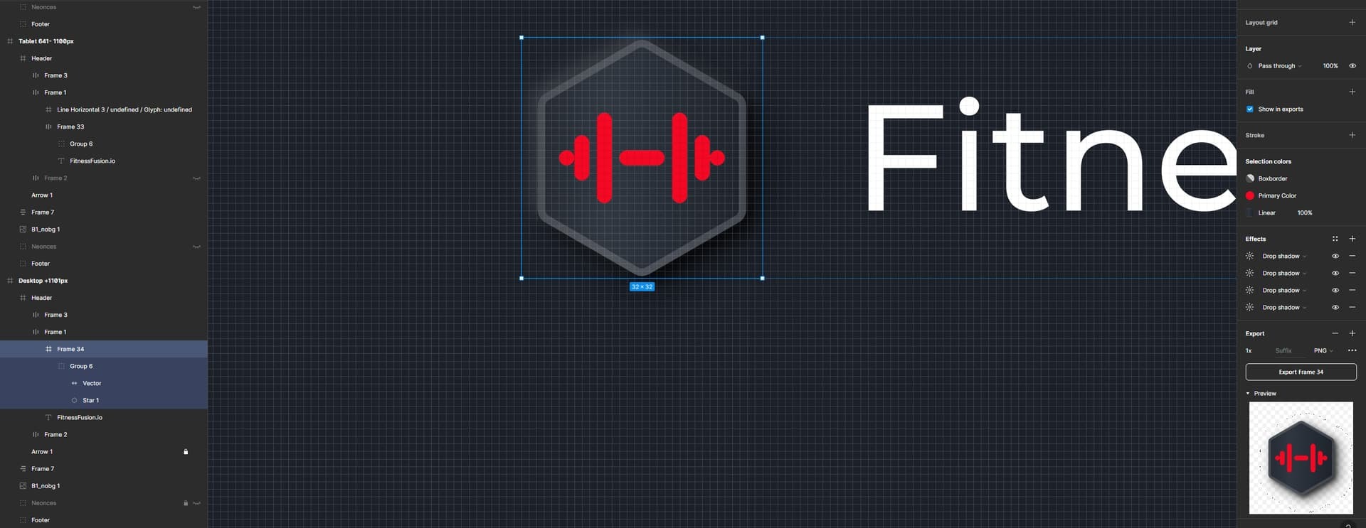

I want to export a hexagon form with shadows. Size 32px x 32px, but when i export it get a png of 44x48 because of the shadows. I tried the frame method, by removing the shadows from my hexagon and put it onto the frame, but i still get the bigger png when I export it, Please help 😃

From what I see with your screenshot, I confirm that the drop shadow applied to the frame in question affects the export size - removing this shadow should help here.
If you select the frame, you can see the drop shadow in the properties panel:
If this still doesn’t help, this may be a bug. Please share a copy of your file so we can try to replicate it here. If you are hesitant to share it publicly, you can also reach out directly to the support team by filling this form: here Our team can have a look at it.
