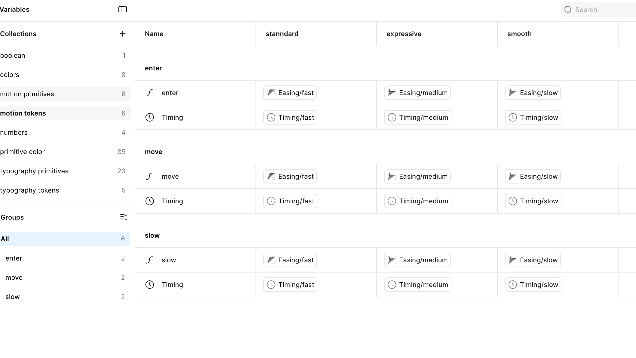

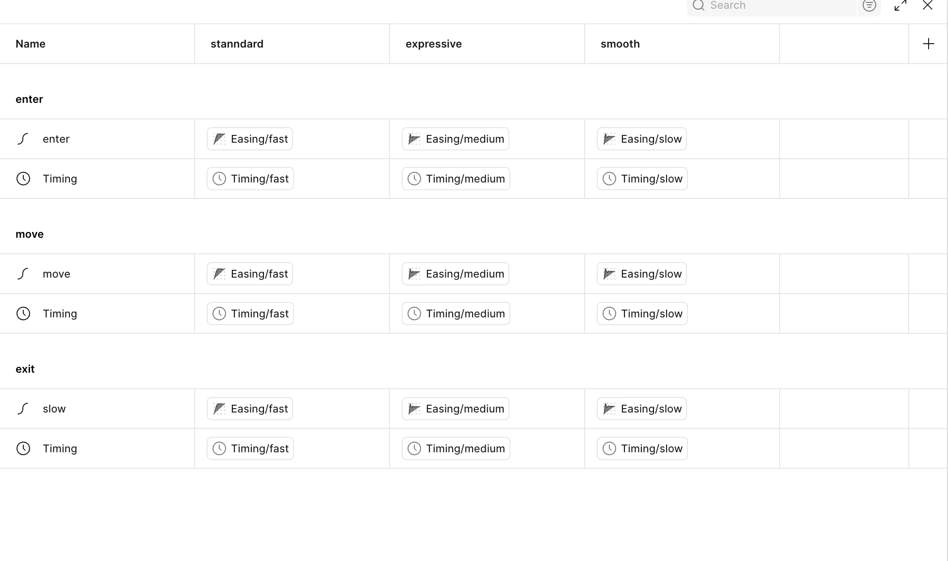

So I made an example of how to use those variables as primitives and tokens

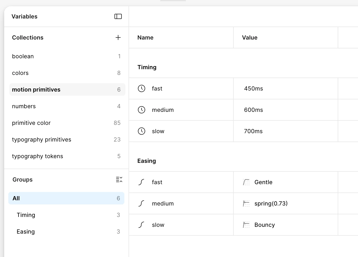

please look at the primitives:
they separate into 2 groups - one for easing the other for timing so if I want to add more variables, I can.
motion tokens separate into 3 modes (standard, expressive, smooth)  and into 3 groups of enter, move and exit. It alias it’s properties from the primitives collection.
please note that easing fast as it mentioned in the primitives collection goes hand in hand with timing fast.
Is that a correct way of naming and working with the new tokens? how should easing names be? Is it like I did - fast, medium, slow or in a different way? If I want to add more easing - how should I name them (it could be faster, fastest and so on but it looks as if it’s more suitable to timing and not easing)? what do you suggest?

Thanks for explaining how you’ve set up your variables, ​@vivi danino. I think naming them something that makes sense to you and your team is best - you could even note this in your design system file what each means with descriptions.
Hmm… Instead of slow/medium/fast, you could use the type with it… something like gentle-slow, gentle-medium, gentle-fast, or something else to provide more of an idea what to expect from that particular easing. I think those make sense with your grouping, though. If you want to add more, you could have -veryslow, -veryfast, or something similar. There’s really no right or wrong way here; it’s what makes sense for you. What you have already seems pretty intuitive to me.
