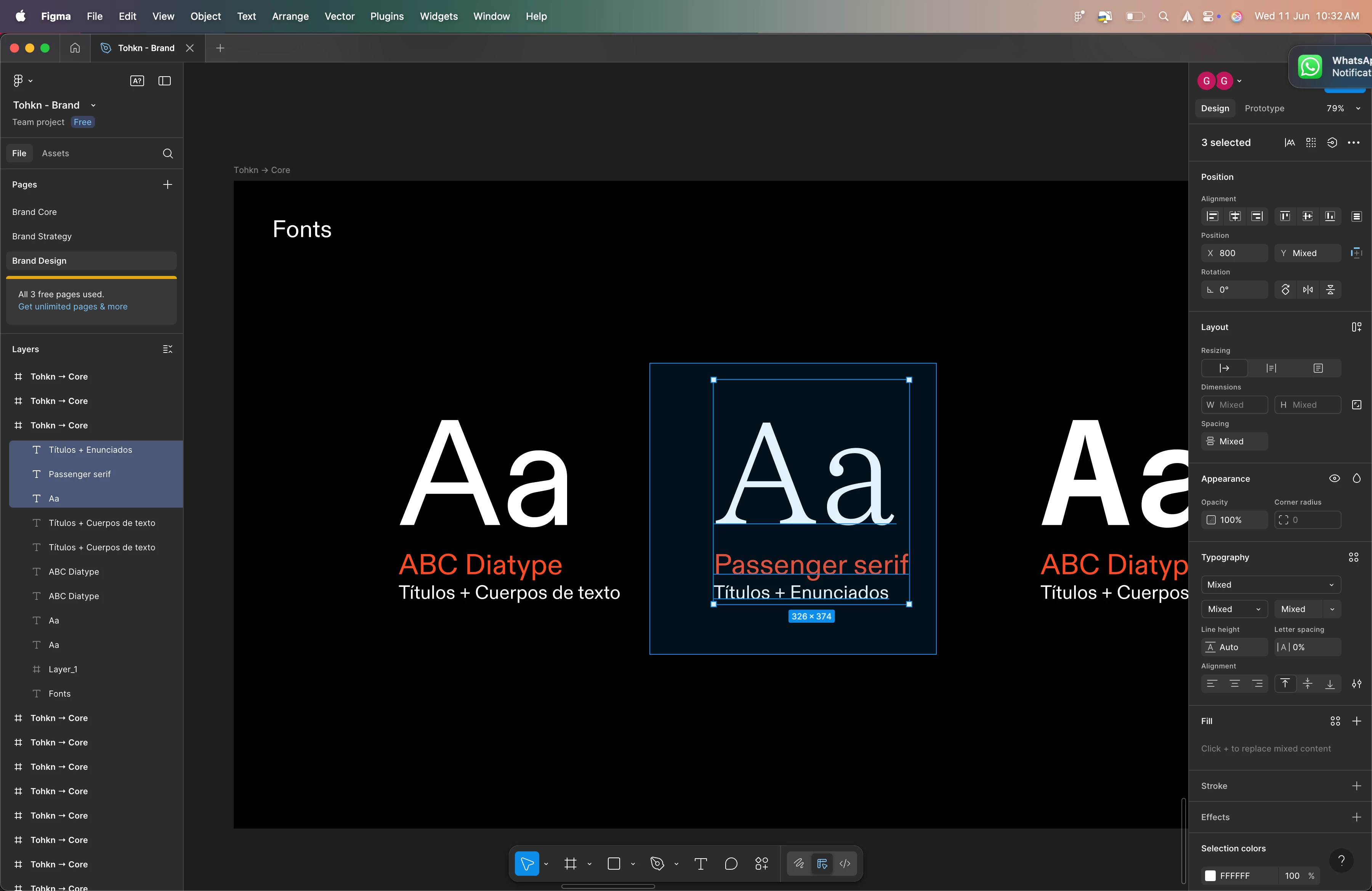

Aguiar_Leonardo_extern
Active Member
Jan 14, 2025 1:06 PM UTC
This isn't working for me either. I am on a MacBookPro M1. Tried it in the Figma app and in Chrome. I have multiple layers with variables applied to them. I use a variable finder plugin that is able to select layers that are using the same variable. I want to deselect some of those layers that the plugin selected for me and I can't drag deselect them. Figma ends up selecting more layers when I drag around the selected layers I want to deselect.

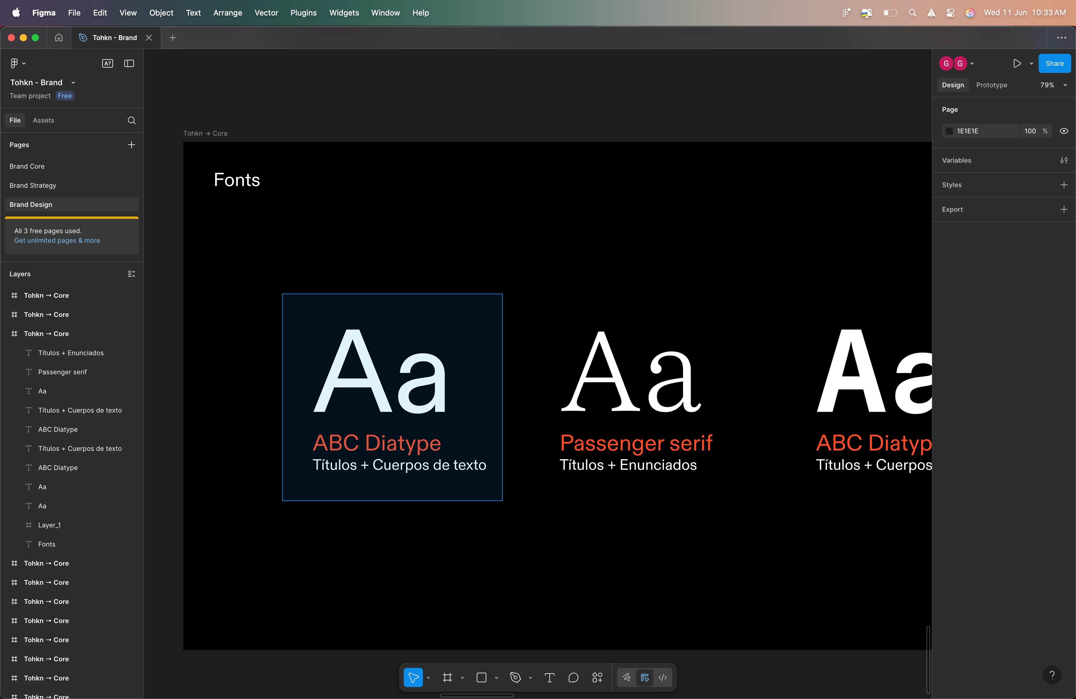

y_toku
Jan 15, 2025 4:05 AM UTC
Hi ​@Aguiar_Leonardo_extern
Thanks for reaching out.
Could you try the troubleshooting below and try again please?
  • Close any Figma tabs you're not using
  • Browser: Force-quit and open Figma in a new browser window.
  • Desktop App: Force-quit the Figma Desktop app and restart it. If the issue persists, try clearing the cache.
It looks working for me as following:
If the issue persists, could you share the screen recording please? Hope to investigate further!
Thanks,
Toku
