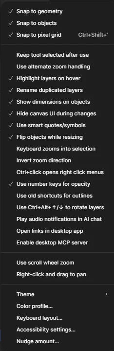

Hi ​@Clare L, thanks for following up!
That’s definitely odd. Here’s a screenshot that may help you locate this setting on your own:
If you’re still having trouble, please let me know what you’re seeing on your end. If you could provide a screenshot, that would be helpful, and we can continue troubleshooting together from there.

We’re working on bringing this back ASAP. Removing this setting wasn't intentional. If you’re still experiencing this today, please try refreshing or reloading Figma. If that doesn’t do the trick, reply right here in this thread so we can look into it for you. Thanks for all the reports! — Jaycee

It wasn’t showing for me either but once I installed the latest update, it appeared! Thank you.

For those who are still looking, you need to go to the Preferences accessed from the Figma logo, NOT from your OS/Finder. Super weird.
And Figma, you need to fix this! Bad, bad user experience! 🤣
https://cleanshot.com/share/gQMCr8HX5jc6BJ2jWN97
