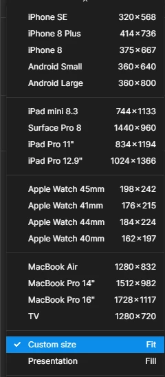

Hi everyone,
I am trying to preview a desktop design after prototyping, but it is showing on a mobile screen. I am using a desktop frame for all the screens. On the mobile screen, I can only see the navbar that I designed, not the entire design.
Additionally, when we click on the prototype, there is a field called device which only has options for mobile views like Android and iOS, but not for desktop views. I have designed both desktop and mobile layouts in the same design file, but after facing this issue, I moved the desktop design to another file. However, I still face the same issue.

Hello!
On the prototype tab, chose “Custom size” as your device, and put it as your desktop frame size, in portrait mode.
You should be able to have different device sizes on a same file, just use different pages.
Hope this helped!

@Apolline Thanks for your help. Tried out the method and it is working.
