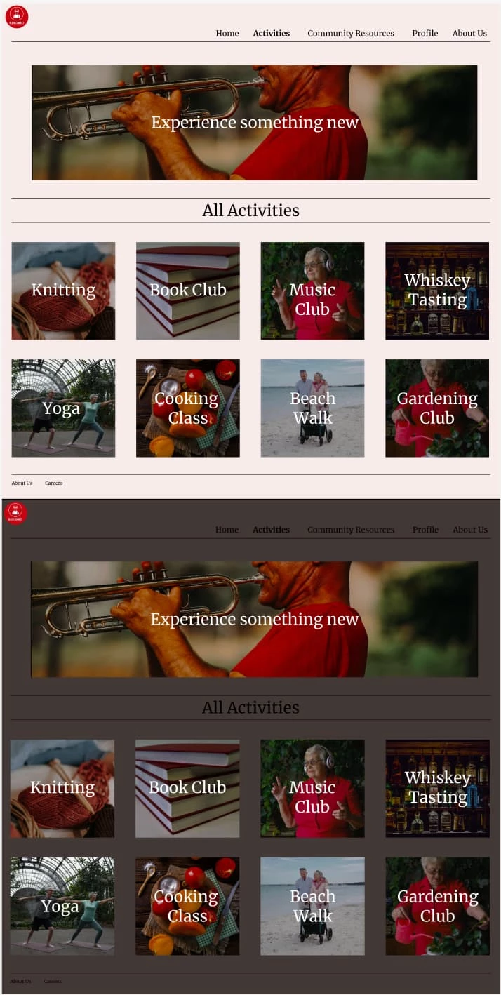

Hi, for some reason my screen looks darker when I click into ‘presentation’ mode after prototyping. I have attached screenshots, I want it to always look like the lighter screen. Any help is appreciated! Thank you!

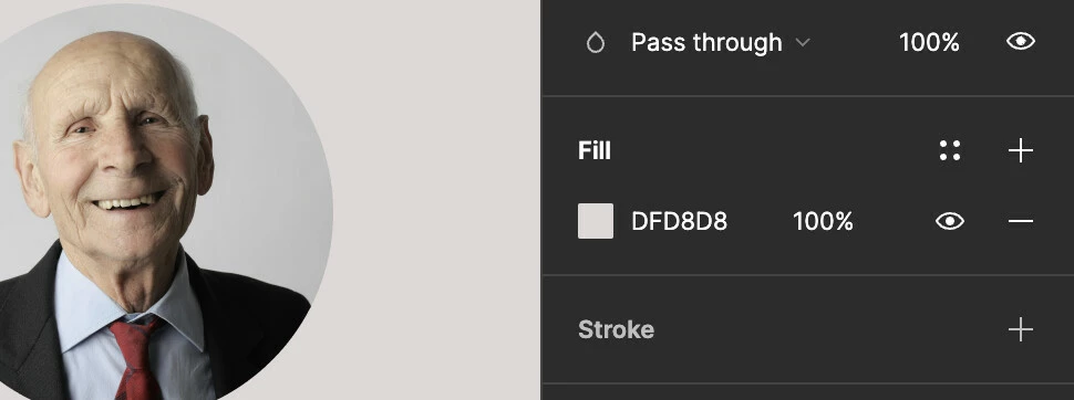

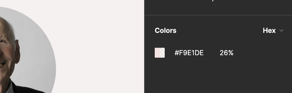

You have set the page color with opacity, 26%. So when it renders on black background it goes dark. You can use #DFD8D8 with 100% opacity and resulting color of page will be similar, or you can tweak it as needed.
