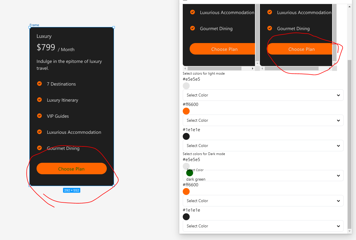

I am developing a Figma plugin that replaces the colors of the selection, with new ones. I want to display on the screen how the change will look before generating it on the Figma canvas.
What I did was to store the node into a variable and then try to change it according to it. What happened was, it was changing the actual component in Figma, not on the copy of the selection have. I want something which can create an exact replica of the selection, and then i want to use it for viewing it on my plugin, because the changes that i do for it is actually affecting the original node.

traverseForColor(getDarkModeNode().clone(), darkModeMapping);
getDarkModeNode() will return the selection directly
tank666
Sep 21, 2023 11:13 AM UTC
Does your screenshot above show a clone or the original frame? Do you see this clone in the layers panel? Does the clone overlap the original frame on the canvas (located at the same coordinates)?
And I don’t see the code for the function to change the clone properties. Are you sure you are changing the properties of the clone and not the original node?
Akshith_Pottigari
Sep 21, 2023 11:20 AM UTC
As soon as the user starts the plugin, I will save the current selection and using getDarkModeNode(), i will get the saved one. And the clones are overlapping upon each other.
