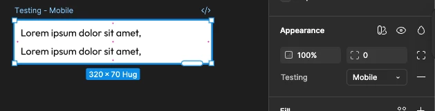

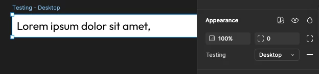

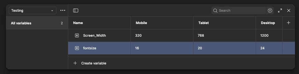

Hi ​@Cherryblossom36 ,
Are you font size vars set alongside the screensize? I’ve setup a quick test as follows and it works fine.
When I copy the group from desktop frame and paste it into the Mobile frame (second line) it automatically resizes it in accordance with the variable set chosen by the frame.
Hope that helps.
Cherryblossom36
Jul 29, 2025 6:41 AM UTC
Yes, i did the same. But i know the difference:
It just doesn't work if I have a text style. But only if it's a group. Interesting!
