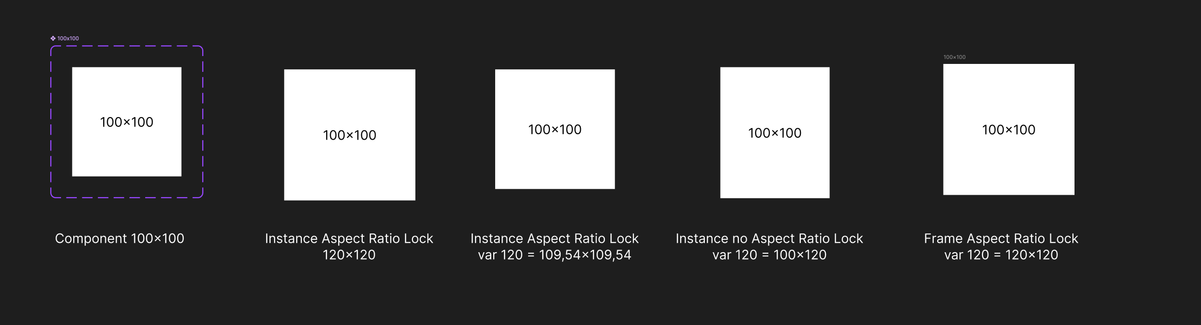

Im having a problem with comonents when the size is set by a variable and the aspect ratio is locked.
https://www.figma.com/design/JZunLI0B65xrRYRCmKWt4I/Component-Size-var-Bug?node-id=0-1&t=0OWhhCZcN6yK8qEP-1
1: You can see in this doc the component is designed in 100x100.
2: With aspect ratio locked and entering the size manualy to 120 things work as expected.
3: When the size is applyed as a var the size is incorrect 109,54x109,54
4 Without the aspect ratio lock the hight is correct when the var is applyed
5: The basic frame not made into a component works with the var as expected.
Has anyone else noticed this behaviour and have you found a sollution?
Thanks
Greg_von_Neulich
Apr 23, 2025 2:11 PM UTC
Ill answer my own question the lock needs to be set on the compont itself as well.
