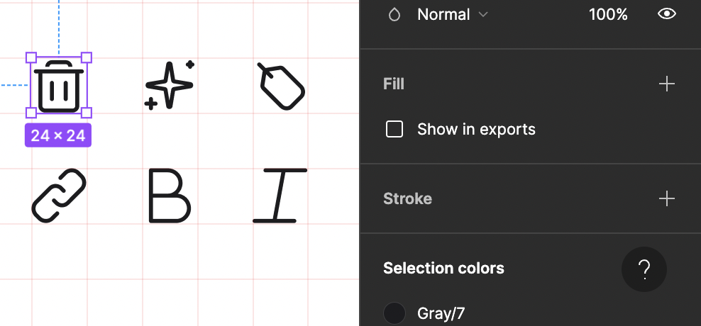

I can’t seem to export certain components without a fill.
The delete icon below has no fill but when exporting, it shows a fill. The ‘Show in exports’ checkbox is only visible under fill for this icon, but not others.

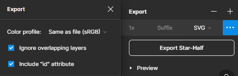

We had the same problem with exporting icons. To fix it, I turned the “Ignore overlapping layers” from the options menu next to the format name (shown in the image). You may test it and check if it fixes the problem for you too.
