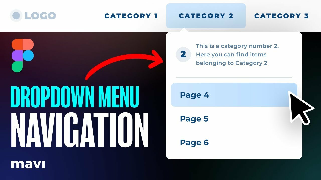

Hey @Neal2, thanks for confirming this!
I’ve found a YouTube video demonstrating something very similar, please check it out and let me know if this is what you’re trying to achieve.
If you’re working on your file and getting stuck on a step, feel free to provide a direct link to the file here, and invite support-share@figma.com with “can edit” permission so we can look into this further? Note that users with @figma.com emails on your team do not count towards your billing.
