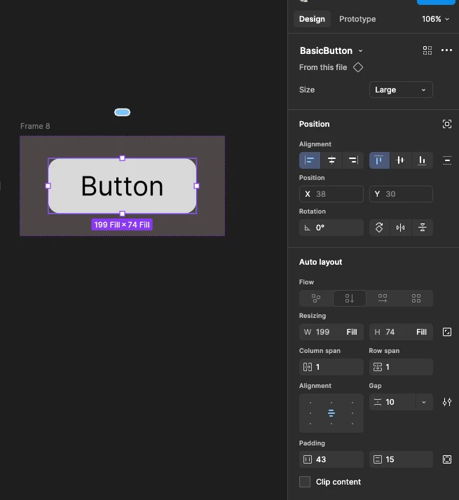

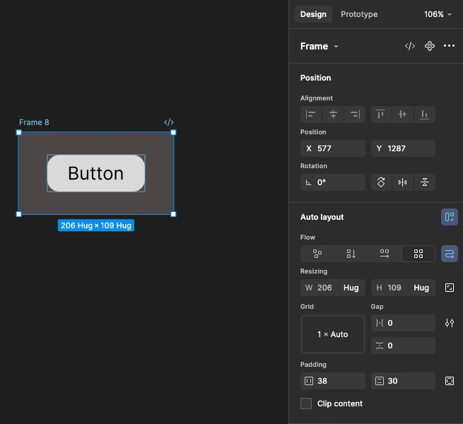

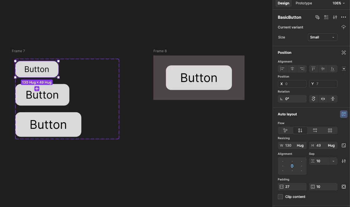

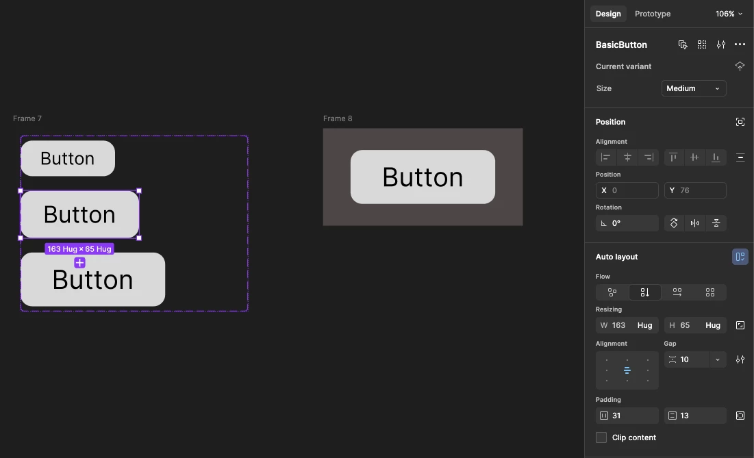

That sounds pretty confusing. Can you check the screenshots I’ve included and see if this closely replicates the sizing and other options of your components? I tried to replicate what you are seeing but the button and frame grew as expected. Well, they did once I remembered to set the parent frame to hug height and width… oops. Here are the screenshots of my test:
Small button selected to show properties.
Medium button selected to show properties.

Hopefully this provides enough info about various layer and element properties so you can tell whether this is an accurate enough replication. I think my buttons all use hug for the height and width so the text size determines the width and height.
