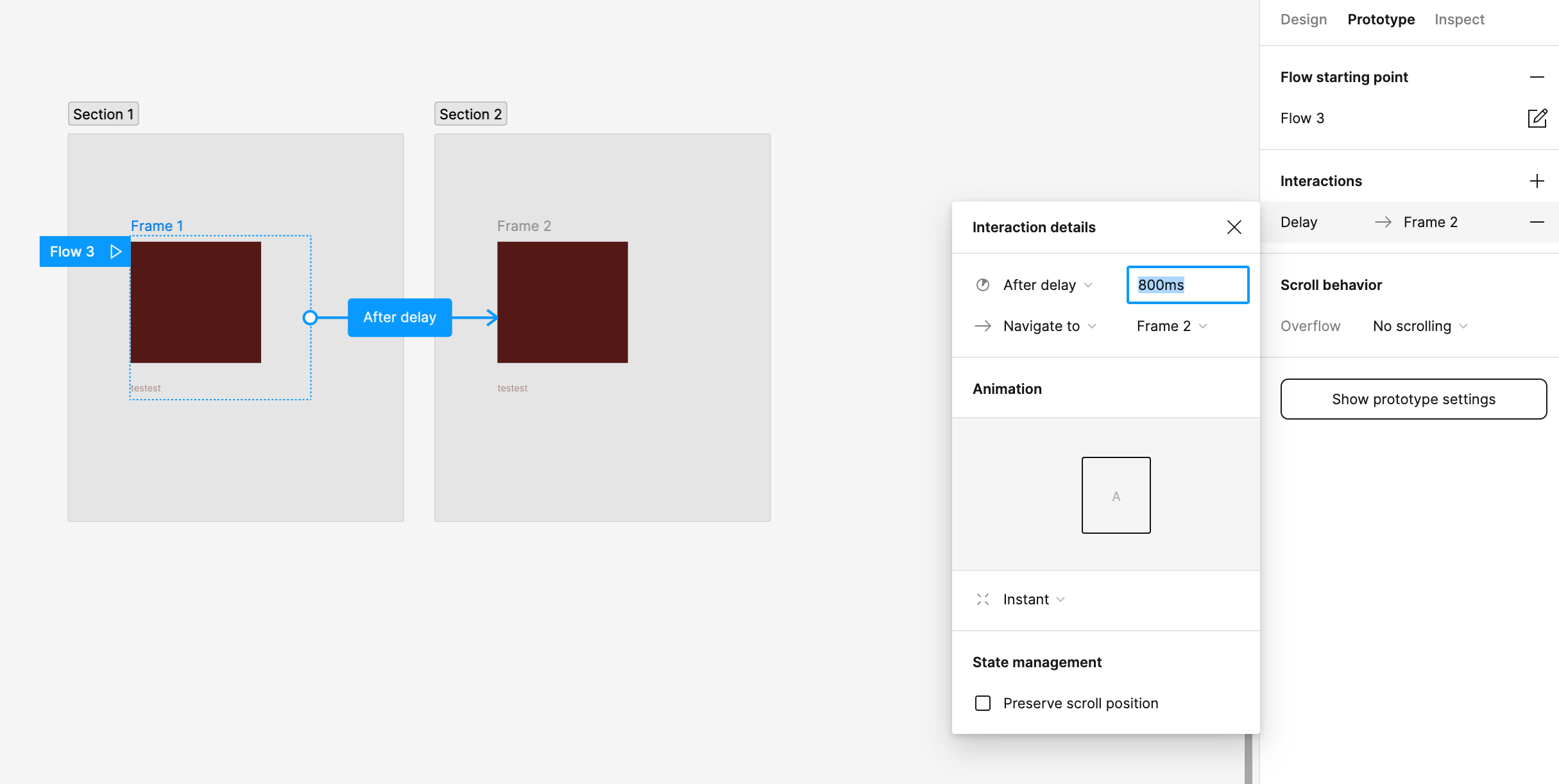

Hello @Soraia_Santana ,
After clicking on “after delay” in the Prototype tab, on its right, you can set the duration of the delay in milliseconds (ms) (see the screenshot below)
(Reminder: You can only apply this to a top-level Frame, not a specific layer or object.)
