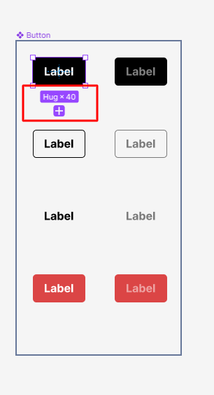

Can you provide some any example code ? Also, I want to arrange the buttons and like image I given in screenshot. also how can I add the + icon to add the duplicate the button and show variant count?
The varintcombine do such thing or there is different way for it?
