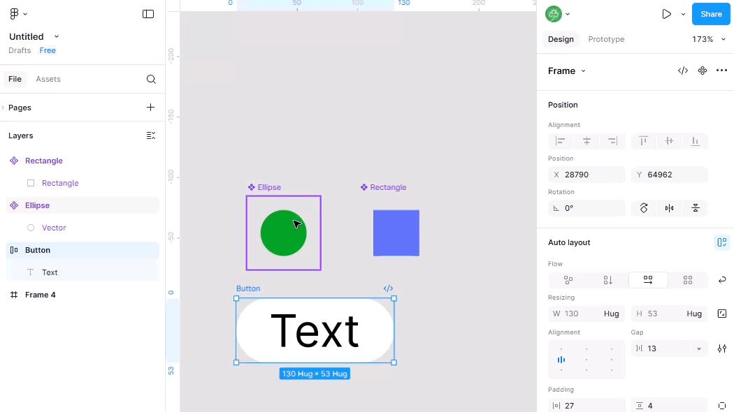

    Hi. There is no link to the file, but this usually happens when the layer names of the vector inside the icon differs. The names must match to inherit the color. It’s not a bug, it’s how Figma works. Here is example ↓

    In large projects with lots of icon components, you can’t really control each icon one by one for changing names of vectors, and this approach just doesn’t work! also not all icons are made of just a single shape ...many of them have multiple vector layers grouped together.
