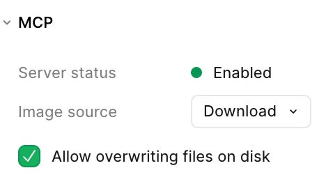

I was facing the same issue and i tried everything, I realized it was an easy fix, Just Check Allow overwriting…. hope this fixes it

​@Dawn Biju  is this option from figma if yes where can found it , or its in Codex

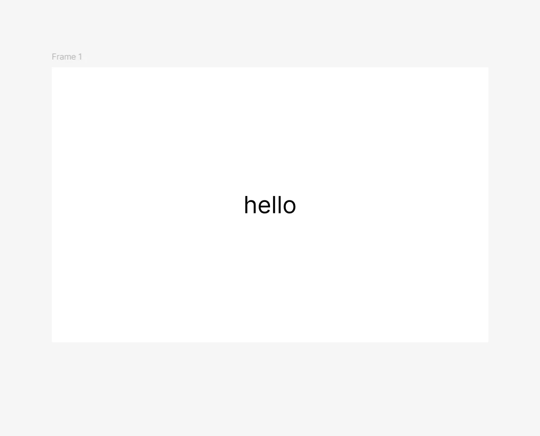

  • I created a new project in Codex (didn’t use an old one), then asked it via chat to create text inside a frame (I pasted the frame link). It reported success.
