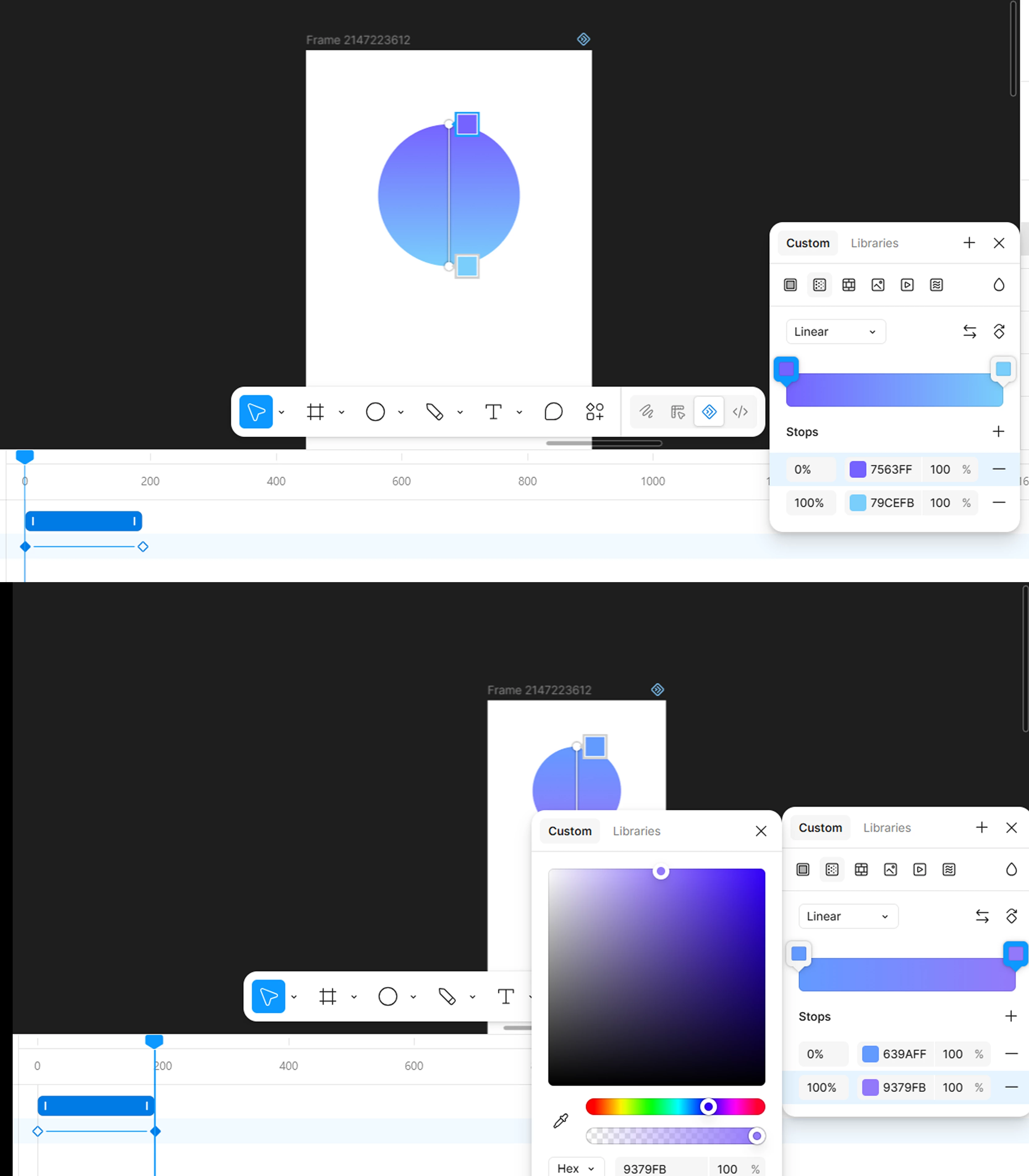

Can we animate gradient using keyframes in motion?
This is something I want to achieve where circle changes the gradient as timeline moves forward.
I'm able to do it for solid colors but not the gradients.
Can you please help?

Here are two ways to do it without animating the gradient values:
  1. Make the gradient three steps, and just move the gradient across the frame.
  2. Layer two gradients on top of each other, with the topmost inverted. Animate the opacity.

nicholaskaschak
Sep 17, 2026 7:10 PM UTC
Same issue here. Trying to animate a gradient across a frame for a skeleton loader and it wont let me do so. (Tried using position keyframes with a nested frame that has a gradient but since you cant do percentages and only absolute positions it breaks when resizing the width of the frame).
