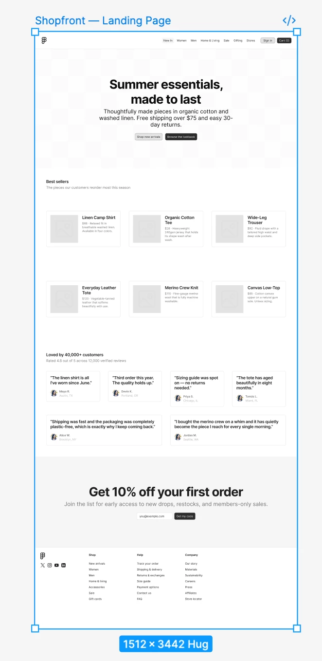

Test 2 (your prompt):
 link https://www.figma.com/design/guOekKl1XbOMCZWiyxX4v3/Untitled?node-id=12-3&t=dxONNrIENRiDhUIo-4
prompt
"design_goal": "E-commerce landing page",
"requirements": "Hero section, product grid, CTA buttons, testimonials"
Result:
Hope this helps. Have fun testing! — Jayce
