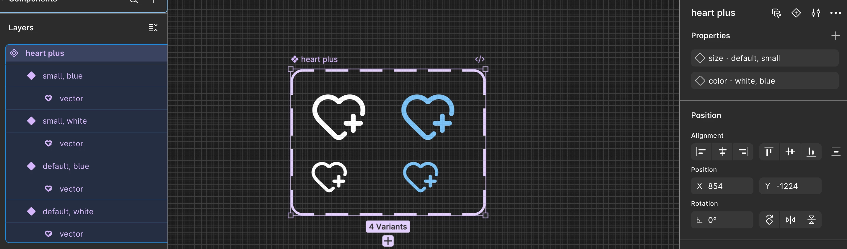

Hey ​@Sunaeva Melyat, I’m sorry you’re facing this issue! To make sure I understand your set up, does this match how your icons are architected?
Specifically:
  1. SVG paths all have the same name (in my example: “vector”)
  2. SVG paths are a single layer, outlined path with a fill
  3. “size” is a variant property (your naming may be different)
  4. “color” is a variant property (your naming may be different)
You also mentioned icon button color—how is your icon button set up?
