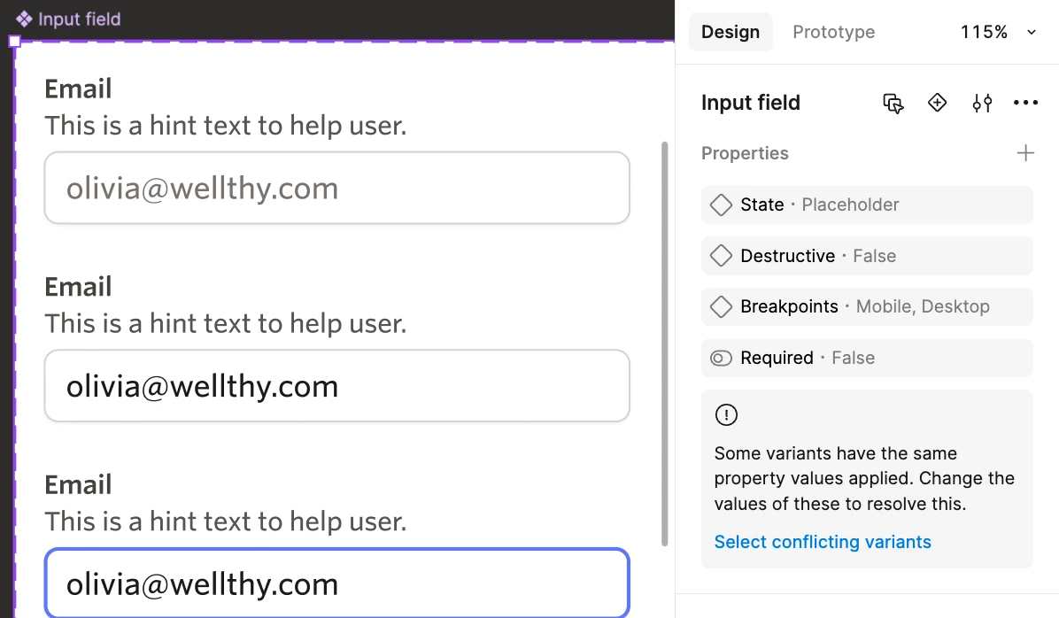

Boolean property successfully applied but it says variants are still conflicting
I successfully applied a boolean property to my layer, but it is still telling me that variants are conflicting. The boolean property works as expected, but why am i getting the error?

If not, conflicting variants will occur when two or more variants within a component set have the exact same name, regardless of their appearance on the canvas.
To resolve this, you want to ensure that each variant has a unique set of property names/values. You can add or update the affected variants' values, or check and remove and duplicated variants within your component set.
You can learn more about it in our Help Center article here: https://help.figma.com/hc/en-us/articles/360056440594-Create-and-use-variants#h_01HKXFK96J022J0Y4SMAP8H3F3
