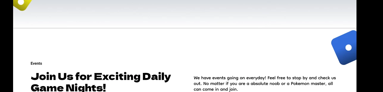

Black lines appear on prototype
In between my groups there seems to be black lines on the prototype but when I look at my design they are no where to be found

    Hi there!
    I've encountered this issue several times. It happens when there's a dark background beneath the frames, and the frames have a 0 gap in auto layout. This causes a thin black line between them in the prototype view.
    My solution was to add a white background layer underneath the frames, which effectively hides the black line.
    Hope this helps!
