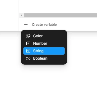

    You may create a string variable in your Local Variables and connect it to your text layer
    I’m not sure what is the limit of the amount of characters, but you may try using it and it can do long texts too
