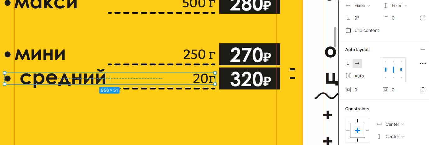

Hello
there’s the layout that consist of dot, word and text with numbers (here-in-after as number)

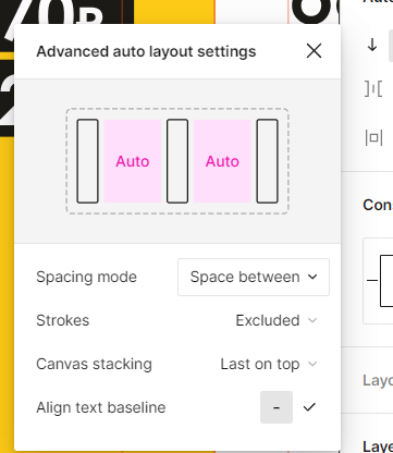

with setting Space between on and Horizontal space between items is auto
I need have dot and word alligning left and number aligning to the right. It looks okay when there’s 3 symbols in number, but if I change to 2 symbols, the word starts to move to rignt
I can’t figure out how to fix it or make my goal through another way, could you give me some advice?
Best answer by tank666
Wrap the bullet and word in an auto layout frame.
tank666
tank666Answer
March 17, 2023
Yul
YulAuthor
March 18, 2023
thank you very much! I’ve tried that before, but now I’ve dug on it a little more and it works now!
