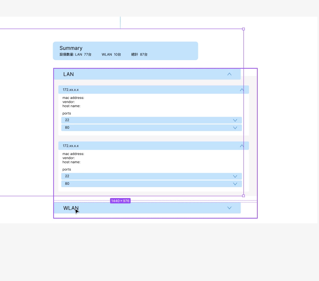

Hi,
I’ve created a dropdown menu using variant function,
and created a component contained 2 dropdown menu for my homepage’s content.

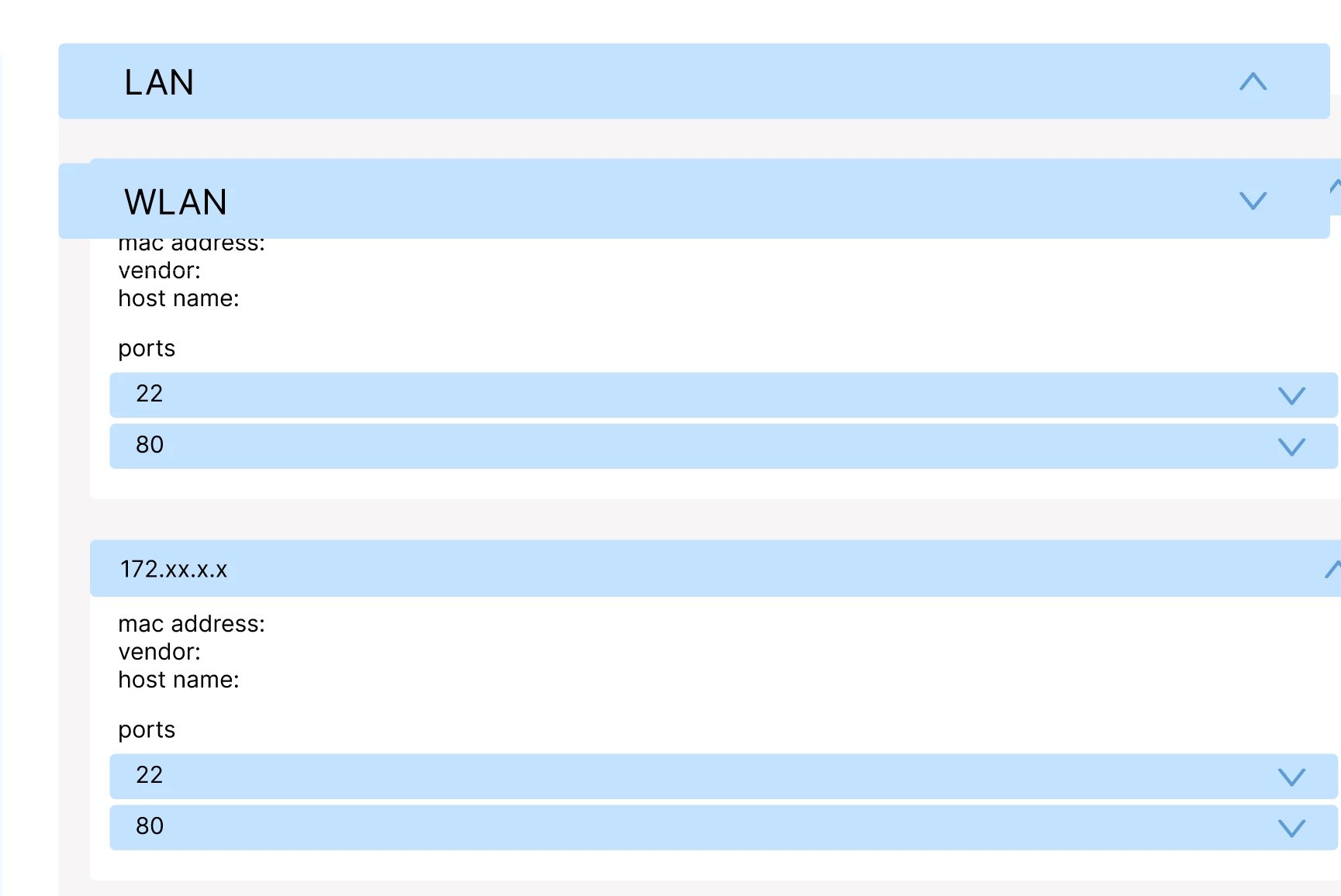

Idealy, when I open the upper one, the contents of the menu will be shown, so the lower one should goes lower.
to achieve this , I added auto layer to those 2 menus(in the same component).
the auto layer do work in the component level,
but when I insert an instance to the other frame, it suddenly doesn’t work.
anyone knows what might I be doing wrong?
this is my file(the component’s name is “page content”, and the instance is in the “local homepage” frame)

It works fine though. Maybe because the frame you inserted it is in clip content so you can’t see the other dropdown?
