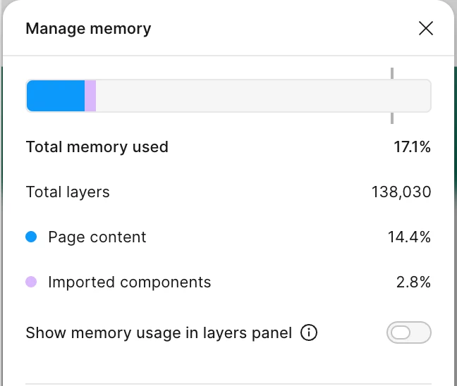

The file is worked on for quite some time now and has maybe become a bit large, but unfortunately, I cannot split it into smaller files, as many external links point into this particular file. But here’s a screenshot of the memory usage, if that’s helpful:

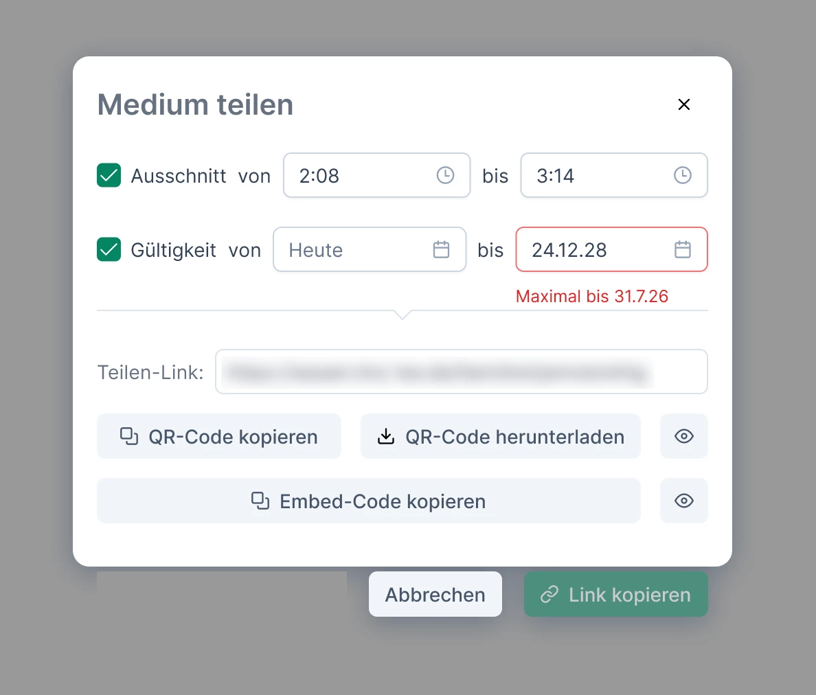

And here’s what the bug looked like: the height of the dialog’s footer is rendered too low, resulting in the contained buttons to hang outside its boundaries.
