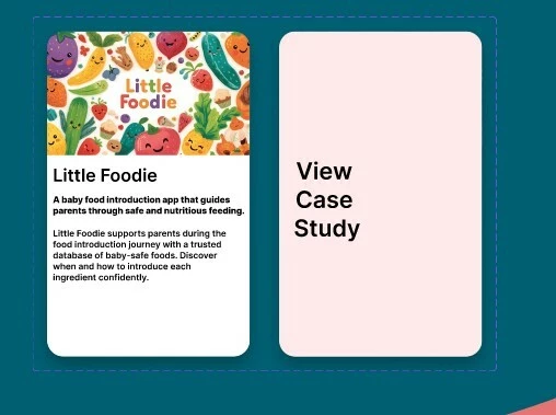

I created the animation on a separate page beforehand because I couldn’t get it to work initially. The animation consists of two Frames, but when I move it to its intended location inside a Frame, both Frames just sit next to each other with no animation happening.

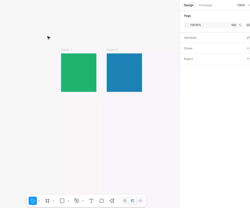

Hi. You need to select both frames and create component set. Then, copy the instance of the first variant of this component and paste it into your frame.

I did that, and it still doesn’t work… I don’t know where I’m going wrong. Again, when I start the preview, the frames stay next to each other like this.

Do not preview that component, copy its intance instead, put it in frame and preview that frame. Here is example ↓
