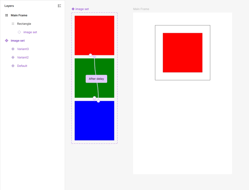

“In Figma, how can I create an animation where different images cycle inside a single rectangle on the main page, without switching frames or navigating to another screen?”
    Raphael_M
    Power Member
    May 7, 2026
    It should be possible if you make the images a component set.
    Then just add this function  to each of the variants
    Then just insert it on the rectangle frame, that would do the work
