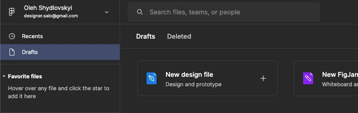

Oleh_Shydlovskyi
Jun 21, 2023 8:11 AM UTC
If you deleted the whole document there is another tab that is called “Deleted” in top left corner of your window and you’ll probably find it.

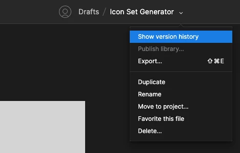

Or if this is not the case and you deleted just a single Page inside document, then open your document, click at the “Chevron / Arrow down” icon right near Document name and choose “Show version history”, there you can find older versions and restore them or create a duplicate with restored version.
