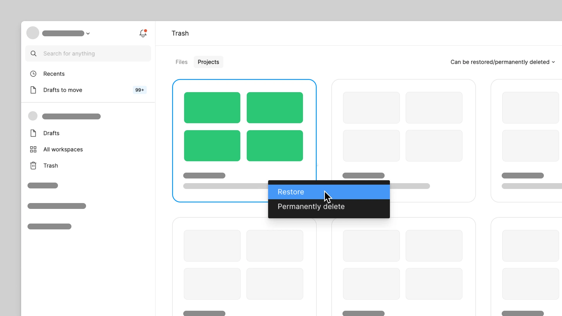

Hey Ben51, Celine from the Figma Community Support team here, happy to assist! Sorry to hear this, especially with your production deadline coming up on May 1st!
The good news is that deleted files go to the Trash first before being permanently deleted. Here's what to do right away to restore a project:
  1. From the file browser, click Trash in the sidebar.
  2. Click the Projects tab and locate the project you want to restore.
  3. Right-click on the project and select Restore to recover them.
Just a heads up, restoring the project will also restore the project and all files belonging to the project for anyone who had access to it at the time it was moved to trash. Files that were moved to trash before the folder got moved to the trash will remain in the Files tab of the Trash section.
If the files are no longer in the Trash and were permanently deleted, unfortunately that action cannot be undone on our end. This action cannot be reversed. However, I'd recommend reaching out to our support team now given your May 1st deadline. They can look into your account and confirm what happened as quickly as possible if you still don’t manage to recover it.
To do that: go to the Support Hub / type "Report a bug" / click Start a chat and explain which project you have deleted. (Feel also free to let me know when you did it, I can flag internally for visibility) Thank you!
